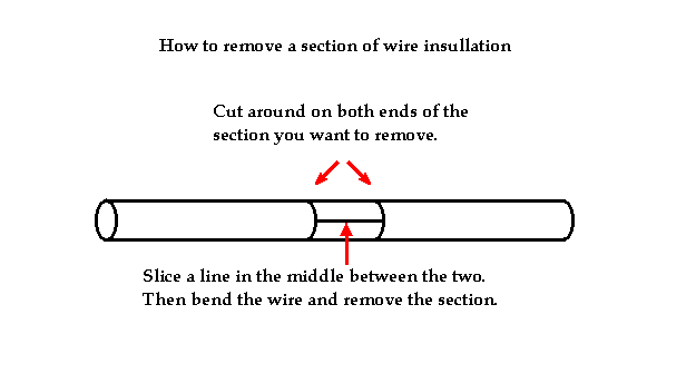

Everytime I do a remote starter install I cut myself a bunch of times.. When I tap into the wires I get a razor blade and go around the wire in two spots then down the middle like this:
Wire Stripper Tool, I’m Tired of Bleedin -- posted image.
What I want to know is... Is there a tool that can do this rather then cuttin my fingers all up each time?
Thanks much!

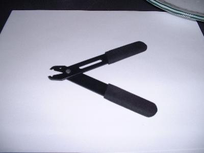

Get a pair like the ones below. Basically just use the correct gauge, cut the shielding in the two spots, then use the tip to pull the shielding away. I am sure someone will mention the kind that strips from the middle but they don't fit in have the places they need to.
