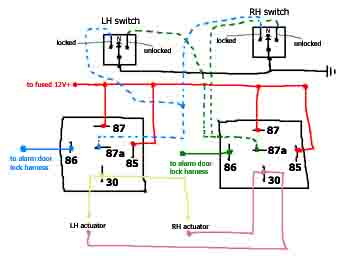

My goal: to be able to use the factory power door lock switches (both LH+RH) I obtained from an SE model to toggle lock/unlock.
Below is the door lock section of my Matrix RSX3.5 installed by the installer. He also added two actuators, and two 610T relays.
Adding a power door lock switch -- posted image.
Do I have to purchase 2 additional 451M relays or can I use the existing 610Ts and connect my two wires (broken wires in blue and green) from factory door lock switch to 87a as shown in the pic below:
Adding a power door lock switch -- posted image.Please note that the switches use ground only and the center pin has solid ground. This wiring is like [url=https://www.the12volt.com/doorlocks/page3.asp#5w]5 Wire Alternating 12 Volts[/url] and a little identical to [url=https://www.the12volt.com/doorlocks/page3.asp#arp]reverse polarity[/url] .
I labeled [b]to alarm door lock harness[/b] because I am not sure it's 12v or ground. When I unpluged the door harness from the brain I got ground when probing the 86s, and got 12v when they are plugged. Anyway, I believe this isn't important to my question in the first place.
What I concern the most is if I can remove the existing ground from 87a (as shown in top pic above) and run the wires from the switches (the broken wires as shown in 2nd pic above) to accomplish my goal.
This thread is pretty much a followup to another thread started by [url=https://www.the12volt.com/installbay/forum_posts.asp?tid=79971&PN=7]crxratedr[/url].

Can't follow your diagram that well, but you should tie the lock switches in to the relays where the alarm outputs are at.

Yes you can connect the wire from the switch directly to the blue and green wire of the clifford, but make sure you add diodes so you do not hurt the alarm.
have the bandside of the diode pointing towards the alarm (neg flow from bandside to non bandside)

I don't understand. Which is the bandside, cathode (side with the stripe) or anode (side without the stripe)?
All I know is that the switch sends negative pulse (lock or unlock). Your saying I splice a new wire to the green wire from the brain, then place a diode between this new wire and the wire from the switch?
(A) switch - (cathode)diode(anode) - door harness on brain
(B) switch - (anode)diode(cathode) - door harness on brain
A or B?
Do I connect the green wire from switch of the LH and RH together, then go thru ONE diode then to the brain or do I use TWO diodes, one for each of the two wires for each door, and a total of FOUR diodes for the whole wiring?
Is 1N4001/L diode the correct one?
When wiring, the position of the diode should be closer to the door harness on the brain or the switch?

i was thinking of placing a diode on the doorlock wire of the alarm (blue and green). Put a diode with the stripe side facing the alarm.
Alarm Brain -----> [ (stripe side closest to brain) diode] ---> meet up with wire from switch --> relay
Yes you can use that

The green and blue wires from the alarm door harness will be tap spliced anyway. So should the position of diode be closer to the brain or the relay, or does it matter?
You haven't answered the total number of diode required for the whole wiring process, so I guess I need TWO since the alarm locks/unlocks both door at the same time, and the door lock switches should do the same thing.
Using diode really sounds appropriate. Most other replies I have received from elsewhere simply told me to just T it in without diode at all.
You know, the factory switch costed me $70 alone, not to mention the close to $700 Matrix RSX3.5 (with all the addons), I really need to get this wiring right and not messing up my alarm.

So, messing with 87a like shown in my 2nd pic above and at 5 Wire Alternating 12 Volts Positive Door Locks won't work or you have no experience on 5-wire scheme and unsure?
I came up with the 2nd pic cuz that's what I originally thought of the appropriate way to do it.
