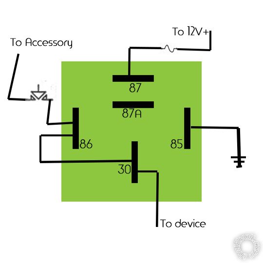

Posted: February 24, 2014 at 6:45 PM / IP Logged
type of relay or suggestions -- posted image.
To be sure, this is what you described Kevin. Is this correct?

Posted: February 24, 2014 at 7:12 PM / IP Logged
Yes, that will work, but make sure terminal 87 is going to an accessory 12V+ source and not a constant 12V+ source, otherwise it will not turn off with the key.

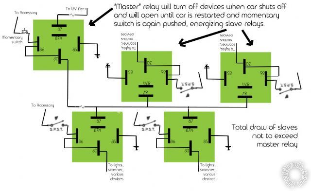

Posted: March 15, 2014 at 1:37 AM / IP Logged
OK - been working on this one. Any expertise is appreciate. What do you think? I figure that instead of the Bosch style auto relays I'll see if I can find electronic ones. But either way, here's what I hope to do with it. I would also run a common ground (not shown on the graphic).
Thoughts? Comments? Suggestions?

Posted: March 15, 2014 at 2:06 AM / IP Logged
I'd forget electronic relays. If space is a premium, used the micro-DIN relays.
howie (aka: harryharris)
Silver - Posts: 355
Joined: February 17, 2014
Posted: March 15, 2014 at 8:11 AM / IP Logged
The micro DINS are smaller than PCB standard pin relays.
Test before boxing up.
oldspark
Gold - Posts: 4,913
Joined: November 03, 2008
Posted: March 15, 2014 at 10:26 AM / IP Logged
Yeah - a micro is about half the volume of the mini - 22.5mm x 15mm x 25mmH + 11mm spade protrusion noting that the coil spades (86 & 85 = 1 & 2) and NO spade (87a = 4) are 4.8mm whereas 30 & 87 = 3 & 5 are normal 6.3mm.
2 micros side by side are a bit wider than a mini.
And mechanical relays are more reliable than solid state.
webpager - one consideration with your wiring is that until the relay actuates and closes 30 to 87, the switch will supply the load current.
If that's an issue, a diode can be inserted between 87 & 86; line end towards 86. Hence when actuated, 87 supplies +12V thru the diode to 86 to keep the relay energised, but the switch +12V to 86 cannot flow thru the diode to 87 and hence the load. Any 1N400x diode will do, but if buying diodes, get 1N4004 else 1N4007 as they can be used for spike prevention - ie, across the coil 86 to 85 with the line end towards the more +ve (namely 86 by convention and as per your diagram). Spike suppression diodes are used when electronics control the relay coil or if spikes are undesirable to minimise system noise (voltage transients).

Posted: March 15, 2014 at 11:57 PM / IP Logged
I notice I saved the graphic with an extra connection in each relay - power going back from 30 to 86. Didn't mean for that - I thought I unchecked those layers when creating the graphic.
They were from the original relay with momentary and drop when power removed relay.
