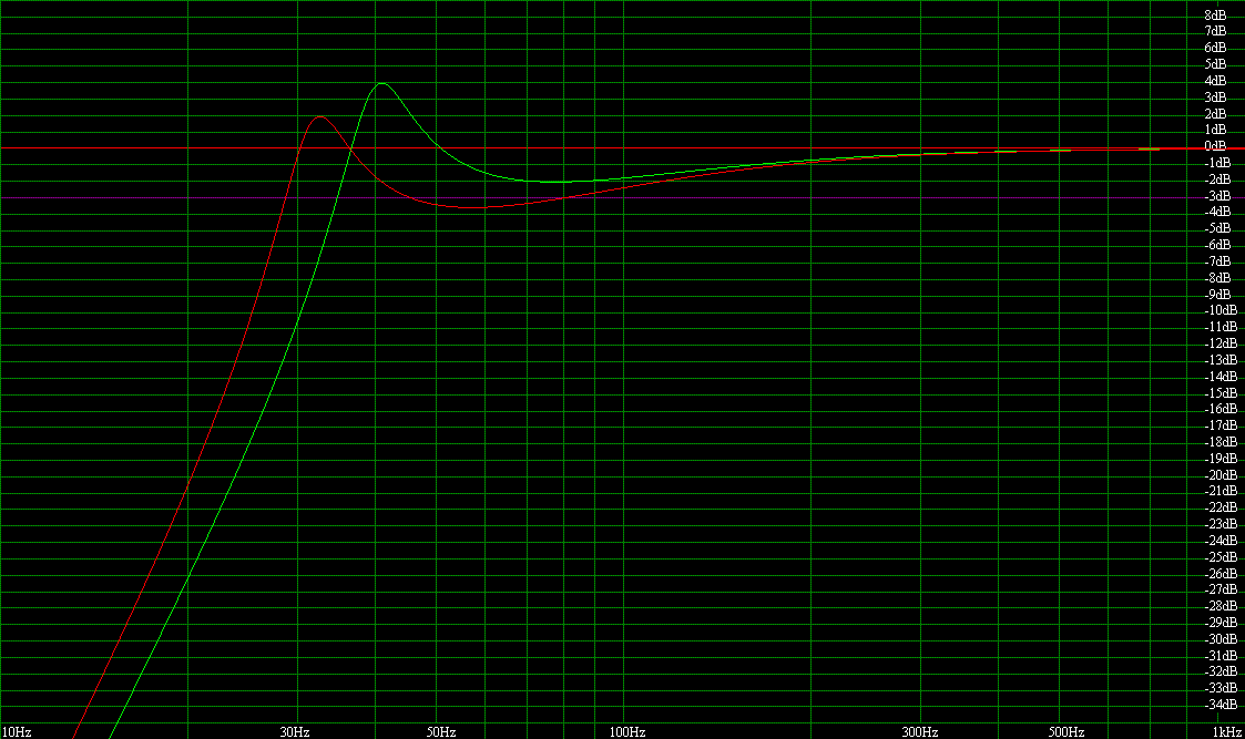

"peaky" ... like there are big jumps in the response of the speaker. Certain frequencies will play MUCH louder than others. Generally, unless tuning for a competetion or something where you know what frequency you need to play and for how long, you want the flattest curve possible.
These are the curves for your speaker, the red line being the "SQ" box. I think the "sq" box is so big so that dip after the Fs will be minimized...
port tuning -- posted image.
Anyway, notice how the falloff on the green curve is drastic? Like it drops almost 11dB from 40 to 30 hz. From my experience, drops like that tend to produce really uneven bass-lines and, unless ur car is well damped, produce more trunk rattle than bass. The fall off on the red curve is there, but wayyyy down into the sub-30hz range, where you really can't hear a whole lot and where you aren't gonna get a 10" to play anyway. The red curve manages +-3dB from reference all the way to about 80hz which is about where you'd want to cross it.
