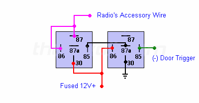

anyone know how to add a retained acc. for radio to remain on until the dor opens????????????

If you wish to keep the radio (or any other device that is powered by an accessory circuit) on until a door is opened, you can do so by creating a latch when the accessory is turned on with the relay shown below on the left, then breaking ground to the latch when a door is opened as shown with the relay below on the right. While this will keep the radio on, the entire accessory circuit will see 12V+ until a door is opened with the key in the off position.(the12volt.com @ relay section)

Would you be able to use a diode between the radio and the rest of the vehicle wiring to keep the juce from flowing to the rest of the accessories?
