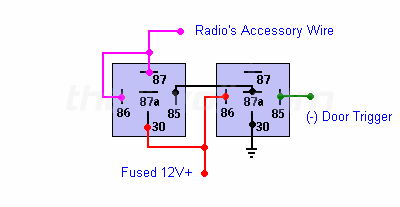

https://www.the12volt.com/relays/page5.asp#drto
Radio On Until Door Opened (Retained Accessory Power)
If you wish to keep the radio (or any other device that is powered by an accessory circuit) on until a door is opened, you can do so by creating a latch when the accessory is turned on with the relay shown below on the left, then breaking ground to the latch when a door is opened as shown with the relay below on the right. While this will keep the radio on, the entire accessory circuit will see 12V+ until a door is opened with the key in the off position.
radio on until door opens -- posted image.

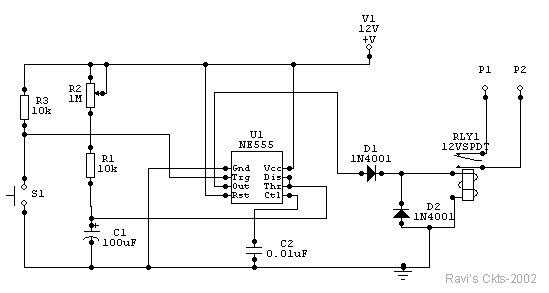

How could i tie in a 555 timer into that setup to control the relays, which inturn keeps the radio on for a about 5 mins if the door doesn't open but still turns off with the door trigger?

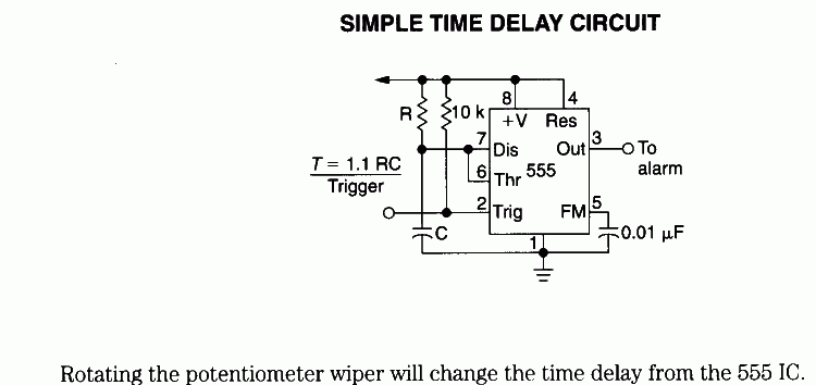

ok, on the first diagram with the 555, the reset and the trigger are interconnected.  Could i connect the reset to the door trigger instead?  On the relay (SPDT) side is were i get a bit confused.  What do i do with 85, 86, 30, 87, 87a on the relay, where do i connect them?  Couldn't i just use the 555 by itself to keep the radio on for a maximum of about 5 mins if the door does open but connect the reset of the 555 to the door triggerof the car, which would turn the radio off when the door opens?

The 555 can not handle much power it needs the relay.

ok, so how do i connect the 555 to the relay?  where do i connect 85, 86, 30, 87, 87a?   I understand how to setup the 555 to power the relay, but i don't know how to cnnect the relay to the 555.  thanks
