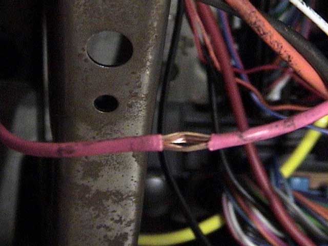

I solder the remote start wires period:
I strip back the wire an inch or more, then take an awl, or my probe/test light and make a gap between the strands:
RS- proper method for splicing? -- posted image.

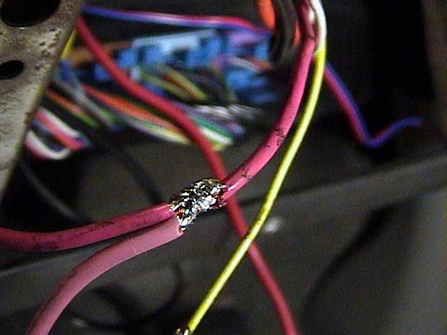

Next, I take the wire that I am soldering to, and insert it and "wrap" it around and flatten it and solder:

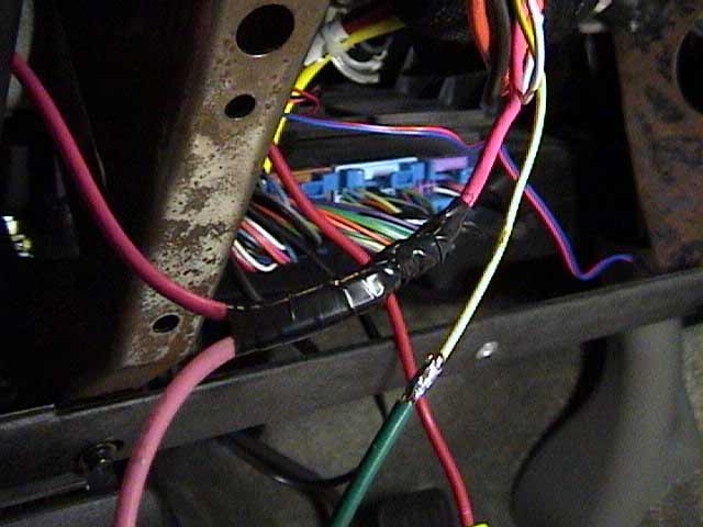

Last step is to tightly wrap it with some 3M super 33 tape:
I've learned that if you're in a tight spot and you have no space to wrap it with the roll, get a butt splice and make your own "mini roll."
Next to the completed one is an "end to end" splice.  I "fuse" them together by simply spreading the strands a bit, push them together and solder.
And voila !
That's my method.
