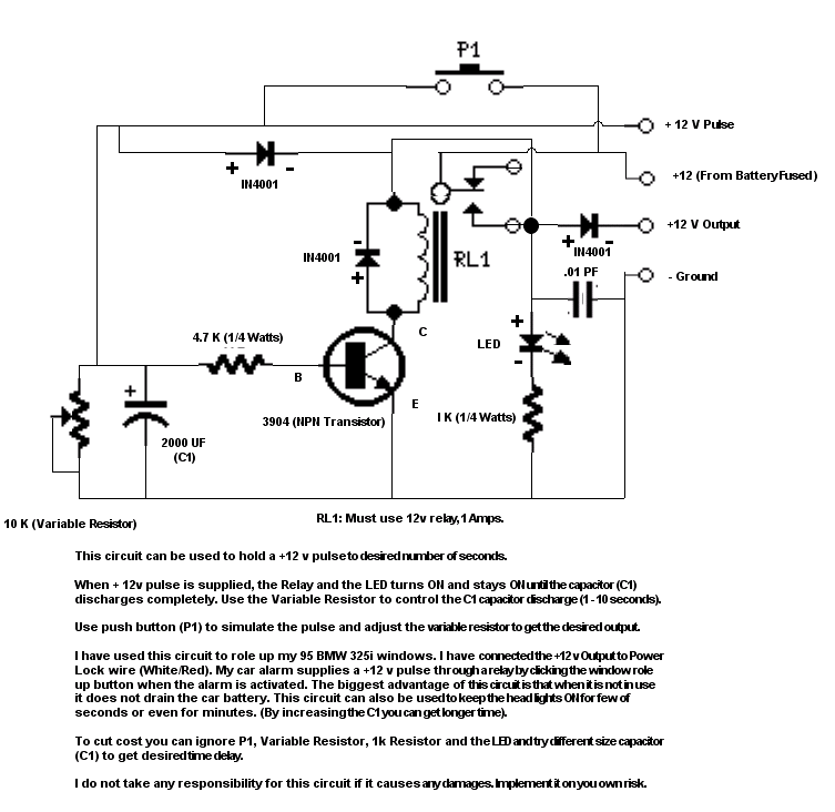

Thank you for the information. I figured that must be the case. Anyways, I don’t need the window role down option. I just wanted to know if I messed up my module some how. This forum is great. For the benefits of other users, I am attaching the circuit that I made to role up the windows. It did not cost me anything since I already had all the components at home

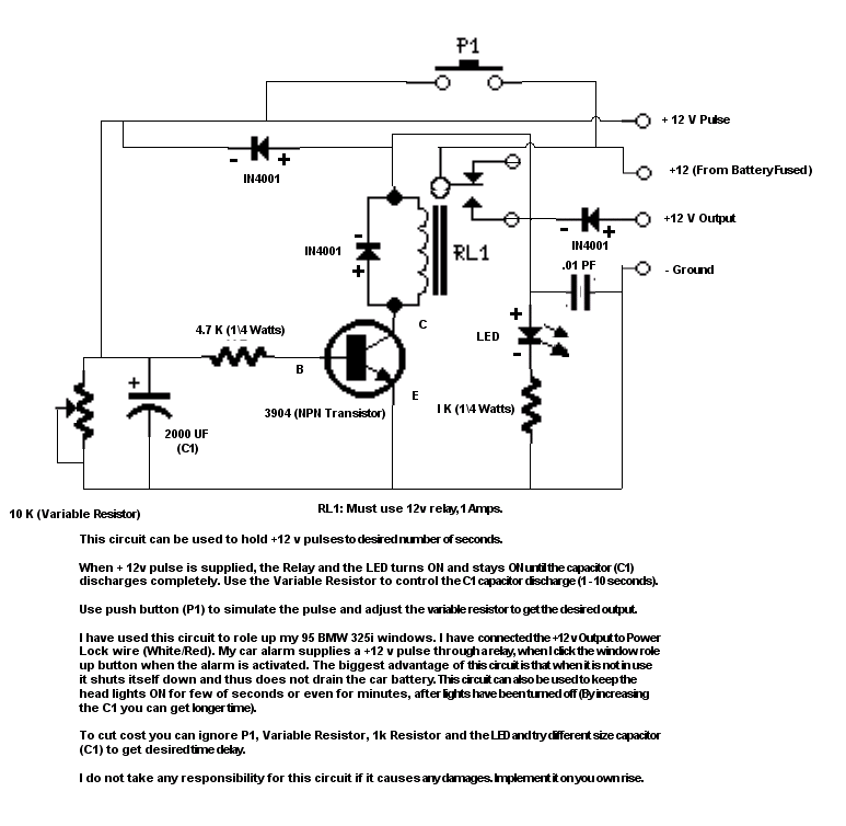

Sorry, I missed a wire in my circuit diagram. Here is the corrected circuit.

That diagram seem alittle complicated. I have a 97' 328i e36 4dr. On the lock relay that is positive I just hooked up a aux. channel to that same relay to extend the lock trigger so windows can roll up. Now for down you are gonna need four diodes and two relays. diode isolate all four door triggers and make a relay for ground. When your send extended ground for door triggers the windows roll down. you also need to use that same aux channel to power a relay
to send power to ignition at the ignition harness to roll down. On this car i highly recommend you dont mess with the window motor wires you will f things up. this feature will only close sunroof but will not open. good luck

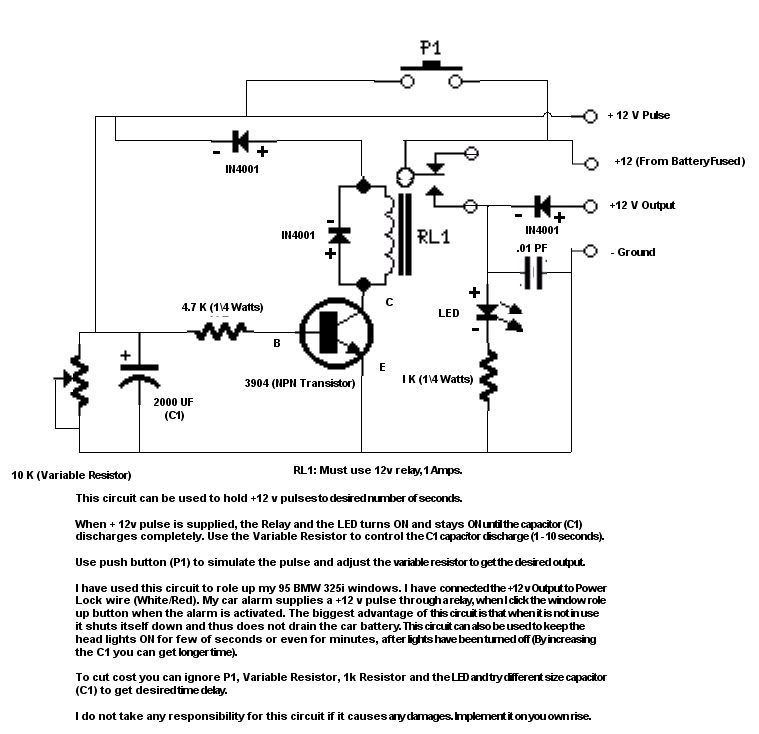

I realized I did not indicate the correct polarity for the diodes.... I made the diagram in hurry and made a mistake... sorry if it has caused any inconvenience to anybody..
