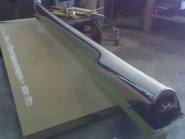

In my example I needed to replicate the chrome rail that runs along the top of a 57 Chevy door panel. After I had my replica I was free to modify its shape with out damaging the very valuable original part.

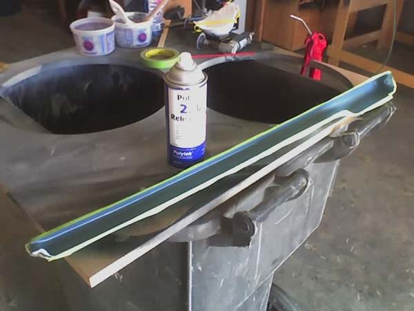

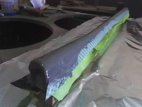

Step one
Here is the original part. Notice that I have used double sided tape to outline where the mold edges are. This helps me demold my part as well as give me a visual line to grind to after I demould my part.
bed cap molds? - Last Post -- posted image.
Step two
Spray the part down with polyease (release agent)
Next I mix the Vette filler with standard polyester resin. 4 parts filler one part resin and mix in only cream hardener no liquid MEKP. And brush on the mix.

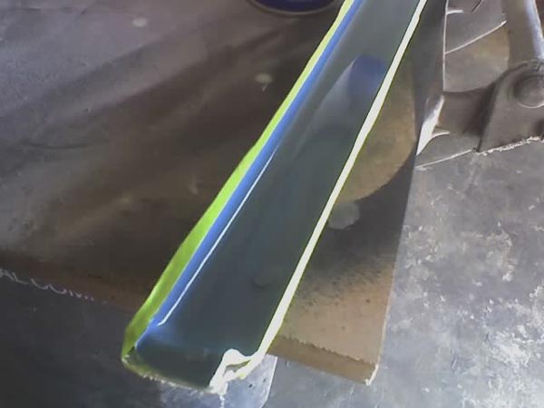

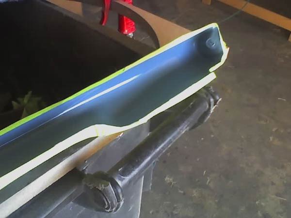

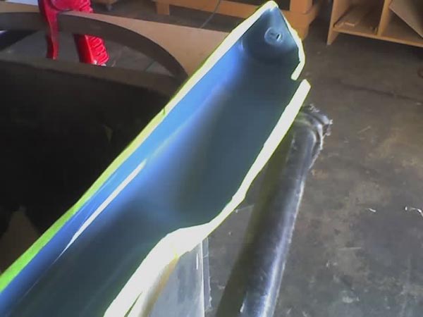

Step three
Using Vinyl-ester resin apply 2-3 layers of fiberglass matt. No sanding required. Use a small roller to thoroughly saturate the matt. While still wet I suggest that you lay down some angle iron and let it bond. This will keep your negative from warping. With a long piece simple gravity will warp your part once off of the truck if its not reinforced. Angle iron is cheap and readily available.

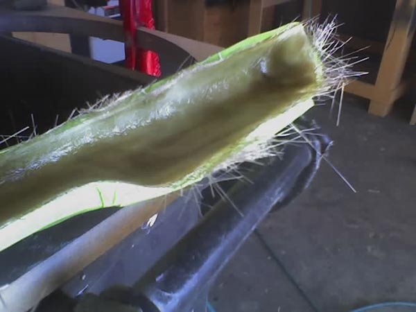

Step four
Pull your negative from the positive (your truck). Use compressed air for this. If you get just a little air between your parts they pop rite apart. As you see in the pic I now have a perfect negative. No warping, no cracking, no pin holes, no sanding required. Denatured alcohol works well do degrease all parts. At this point If I were you I would shape the top surface of your new panel using the vette filler as your bondo. Prime, and paint.

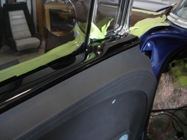

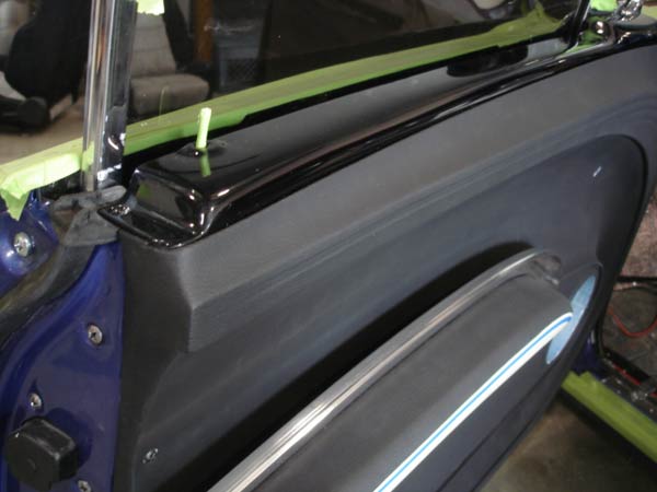

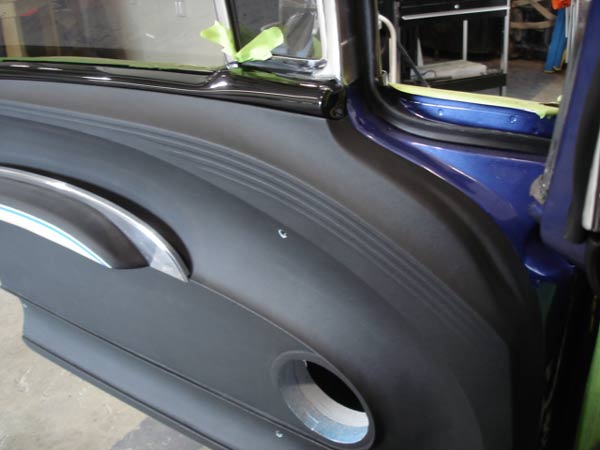

The remaining steps on my project
Now that I have this flawless negative I respray with polyease and paint more vette filler/resin mix into the inside. Then fiberglass matt. When I pull my part all I have to do is degrease, prime and paint. No body work!
This is the black part at the top of this door panel.
