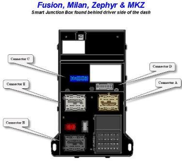

Here is the 1041.
Lock Gray / YELLOW (9) In Driver's Kick Panel or SJB Conn. C Pin4 (3) Negative
Unlock  PURPLE / Gray (9) In Driver's Kick Panel or SJB Conn. C Pin10 (3) Negative
Driver Door Unlock  Blue/Green At SJB Connector E Pin 27 (5) Reverse
SJB (Smart Junction Box) under driver's side dash.

Green from 50.5x-gray / YELLOW (lock wire) use relay if it locks intermittently.
The light blue from the three pin harness of 50.5X goes to the drivers door as described below whereas the H2/1 goes to PURPLE / gray to unlock the other doors - use relay if it unlocks intermittently.
To do the drivers door, you need to cut the blue/green and send a positive trigger towards the drivers door using a relay. See page 21 of doc 1041.
