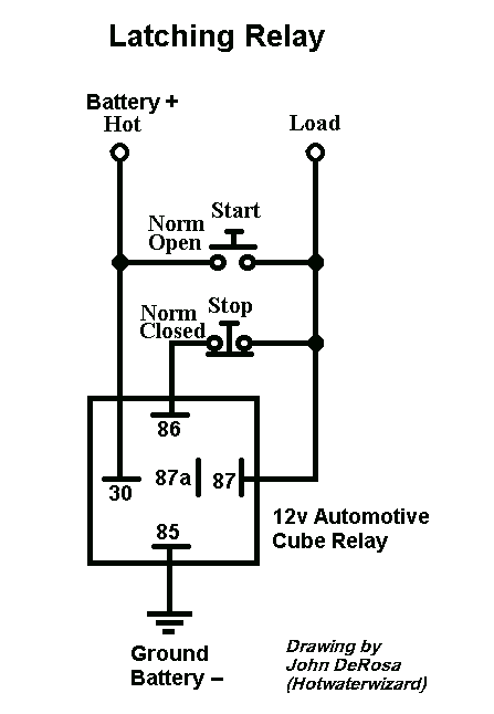

hotwaterwizard
Silver - Posts: 1,350
Joined: December 11, 2003
Posted: November 09, 2008 at 1:11 AM / IP Logged
difficult wiring custom fold out screen - Last Post -- posted image.

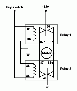

hotwaterwizard
Posted: November 09, 2008 at 1:21 AM / IP Logged
