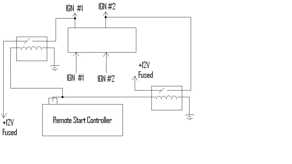

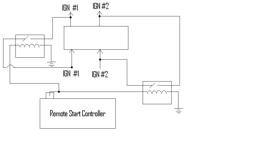

I've found the wiring information for the vehicle (SEE BELOW), but am confused as to whether relays are required for EVERY SINGLE CONNECTION OR NOT??
Also, do the relays need to connect to +12 V (fused to the battery) or can I use them to just bypass the ignition coil? (see attached picture).
Are relays required in similar setup for the other connections?
(Wiring information --> https://www.the12volt.com/installbay/forum_posts.asp~TID~26788
2002 chrysler sebring, compustar - Last Post -- posted image.
or...
Are both of these viable options?

I just have a couple of questions. Installing a compustar remote starter into 2002 Sebring Sedan.
My remote start unit has - outputs for lock/unlock. I need to use resistors and relays for it to function properly. No big deal really. The bypass unit has lock/unlock INPUTS.
Do I need to send the lock/unlock signal into the bypass BEFORE or AFTER the resistors?
Do I hook up the remote start unit to the lock/unlock wire, or just to the bypass?
ALSO --> My remote start has 1 ignition output, my vehicle has 2 ignitions. Can I use the one, high current, output to trigger a relay to supply power from batter to second ignition???
no resistors needed when using the bypass
just to the bypass
yes
