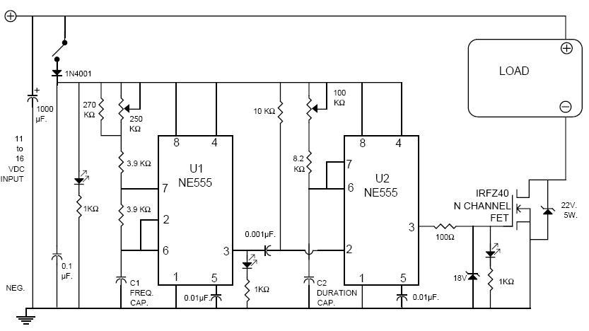

i also have a simple circuit design you could use if interested. it uses 2 NE555U IC's and two adjustable pots to control the timing of the pulses and the duration of each pulse.

That would be great Ckeeler! Please PM us or post the schematic electronic turn signal substitute? - Page 2 - Last Post -- posted image.

C1 and C2 are used in conjuction with the adjustable resistors to control U1 and U2. U1 controls how often the pulses happen and U2 controls how long each pulse is. with this setup you can run up to a 20amp load.

THANKS ckeeler. Appreciate the schematic :)
