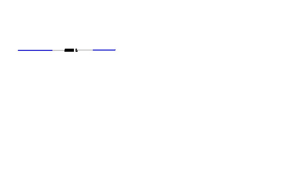

the wire is cut and the diode is put "inline". like this

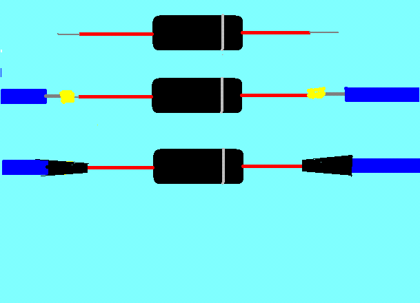

In order to be able to use the diode again if necessary, I strip insulation off of some 18 Ga. primary wire and insert it over the legs as depicted in the first diagram.  The wire insulation is red.   Then insert heat shrink tubing over each end of the cut wire.  Solder the wire to the diode as depicted in diagram 2.  the solder is yellow.  Then slide the heat shrink tubing over the solder joint and shrink it.  As depicted in the last diagram.
