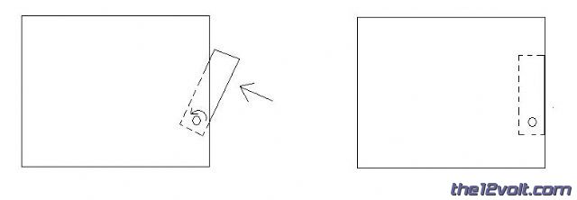

Here's a little picture I drew in MS paint, to give somewhat an Idea of how I want it to work:
making an automatically actuated compartment - Last Post -- posted image.
I'd like to just be able to press in on the side of the seat and have the radio automatically swivel out in a smooth, fluid motion. Then be able to press it back in so it locks in place. I'm not sure how I'd go about doing that though. Any one got any ideas?

alright, I've been doing some scratch drawings and I think I've figured out how I plan to build it. The only base I don't have covered is the little piston that will make the radio pop out.
I'm thinking of something along the lines of a car-hood piston; only way smaller, and not as powerful. Anyone know where to source such an item?

hi,
looking for something such as this:
http://www.mcmaster.com/#miniature-gas-springs/=3cjuuz
scroll down the page
