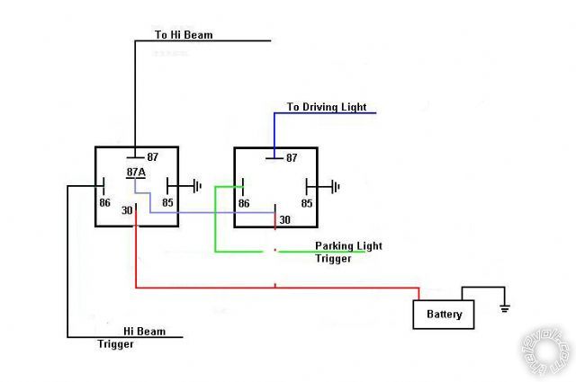

forgot the diagram.
Vehicle Lights Wiring From Scratch - Page 2 - Last Post -- posted image.

If it works and you are happy with it, keep it.
It suffers from the SPDT (changeover) failure that I mentioned, but it only uses a high-beam switch (the low beam being on when the park lights are on (assuming hibeam is NOT on and that the hibeam relay (LHS) has not failed).
For other wiring, use the wiring of any car... almost.
Indicators are battery - fuse -(IgnKey)-(fuse)- flasher-can - into a 2-way centre-off switch. Each side goes to the indicator bulbs (+12V).
Brakes are battery - fuse -(IgnKey)-(fuse)- stop-switch - to brake bulbs (+12V).
Whether you wire thru the IgnKeySwitch (or its relay) and have additional circuit fuses is up to you.
