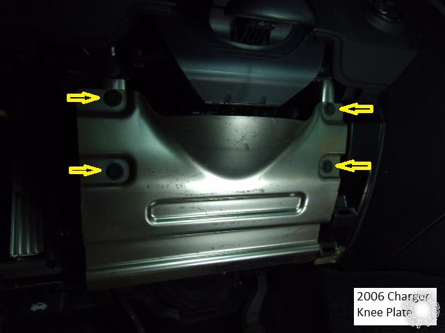

Remove the upper side dash trim piece shown to expose one lower dash panel retaining screw.  Remove the other
lower dash panel retaining screw indicated with the yellow arrow, then pull the panel straight away from the
dash ( three clips along top edge ).  Disconnect the Hood Release cable and trunk release harness.  This will
expose the knee brace which is held in place by the four 10mm bolts indicated.

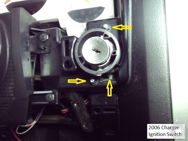

There is no need to remove the steering column covers but for better access to the ignition switch harnesses,
remove the instrument panel bezel.  ( The main ignition harness is easy to reach but the transponder connector
is difficult.)  There are 3 screws along the lower edge.  Lower and fully extend the steering wheel, then gently
pull the ignition switch trim bezel out and then pull the instrument bezel away from the instrument cluster.
This will expose the ignition switch.  The ignition switch is held in place by three 7mm nuts, shown below.  The
nut at the bottom does not have to be removed, just loosened.

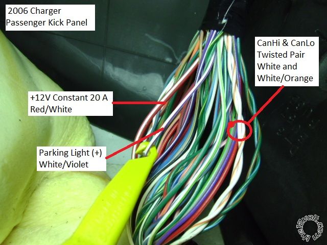

Here is a photo of the main ignition harness with the wires identified :
2006 Dodge Charger Remote Start w/Keyless Pictorial - Last Post -- posted image.
This  is a shot of the transponder connector with the CAN wires indicated :  ( Go by the pin location as the wire
colors can be different.)

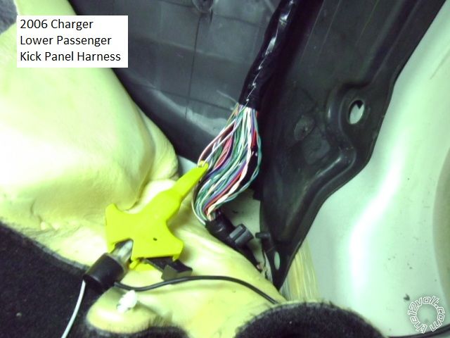

Roll back the carpeting in the passenger kick panel, as shown below, for better access to the wire harness :
Here is s picture of the Parking Light wire :

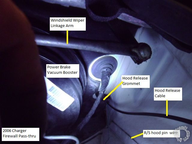

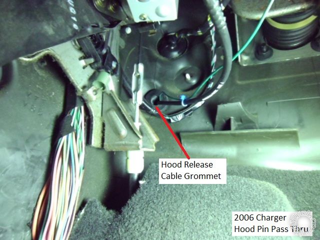

Firewall pass thru for the Hood Pin is available in several locations.  The photo below shows the hood release
cable grommet under the drivers dash, in the left corner.
Remove the brake fluid reservoir panel cover in the engine compartment for better access to the hood release cable grommet
shown below :

Panel a came up empty.  Got lucky in the Passenger Kick Panel with the thick RED / White pictured.  That is what I
used for the R/S power source.  I believe this RED / White wire supplies power to the passenger power seat, which
this vehicle did not have.
