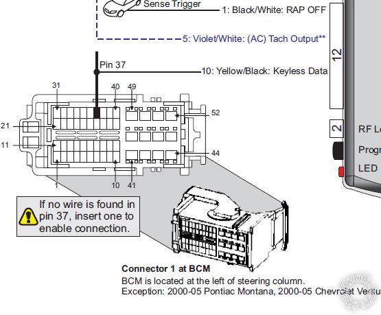

Running into one problem. The manual for the DBALL states to connect the keyless data wire to Pin 37 on the BCM. However, there is no pin 37 on the BCM and the plug looks nothing like the one shown.
Here's the diagram (I'm using Type 3 installation).
Link to the pdf guide.

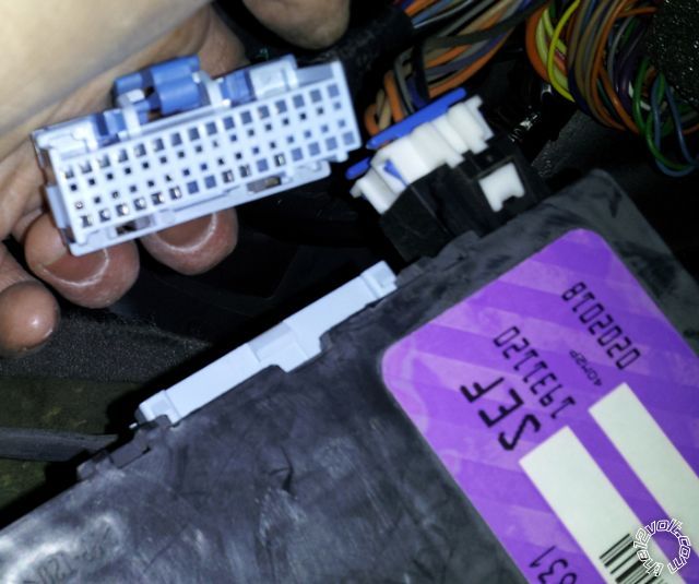

Here's the actual plug at the BCM (behind glove box to the right).
02 montana bcm pin locatiion , dball - Last Post -- posted image.
You can see the plug only has 2 rows & 15 pins in each row.

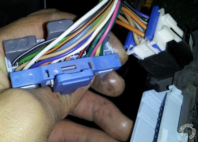

There's also a smaller white plug as well, but again it looks nothing like the one in the manual.

it tells you in the diagram you posted, if no wire in pin 37 then you need to add the pin if you want those functions. i guess keyless data means that it operated the locks through data but like auto enhancers said i would hardwire the locks if you dont feel comfortable adding a pin to the BCM.

i just realized that you are looking at the wrong plug. the plug with pin 37 looks completely different from the one you have in your hand. that plug only has 32 pins, 16 on each row. the plug you need will have some sort of lever that you unlock and slide to pull the plug out. please pay attention to these things because you dont want to mess something up at the BCM. the picture they give youof the plug is exactly what it should look like.

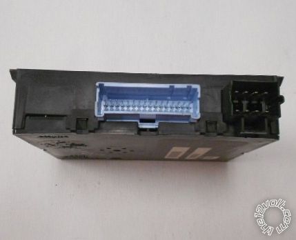

Searching for a BCM on ebay yielded this picture, so I know for sure that I was at the BCM and not something else...

For anyone that may need this in the future, the keyless data wire is a BLACK/ white wire in connector C2 of BCM (you can see it in the 3rd pic of the first post).
