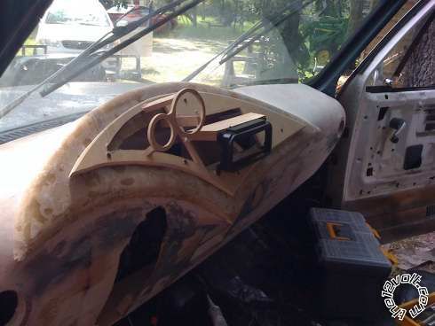

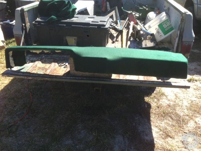

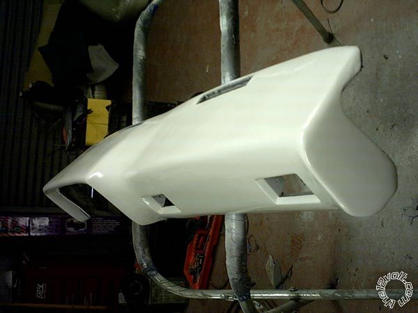

Here is my OLD dash that I was working on
86 Chevy C20, Fiberglass Dash and Doors - Last Post -- posted image.

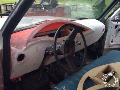

Another photo of OLD dash

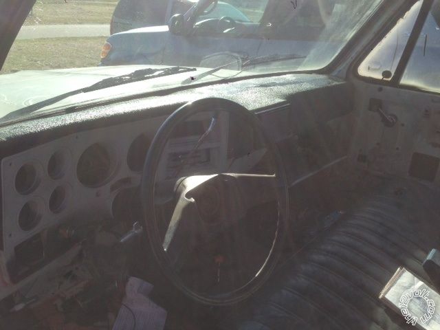

THIS photo is kind of the look Im going for. I figure (hopeful) it wont be as tough as the last one I was working on.
please note: this is a photo I found on google

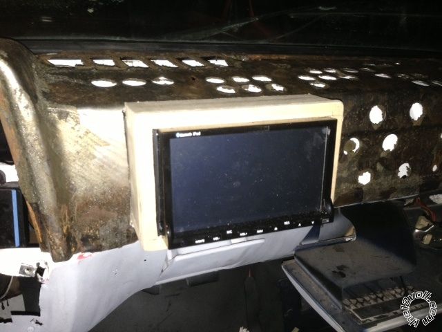

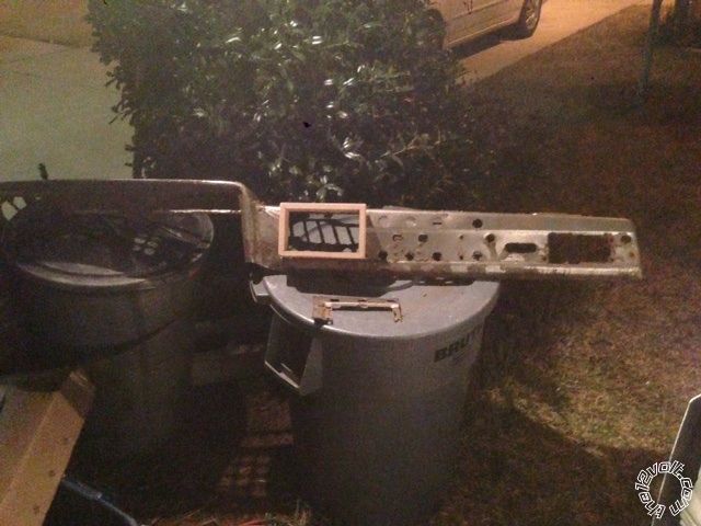

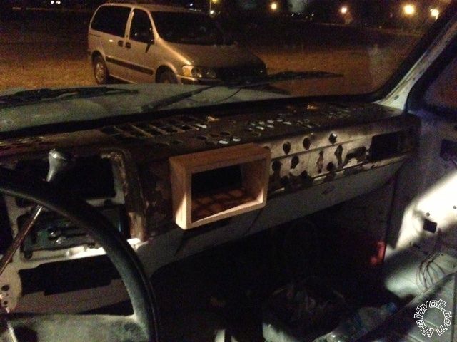

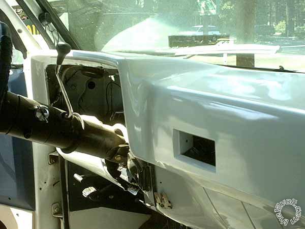

ok so like always things have changed. I was wanting to completely cut out the old metal dash and start from scratch but I dont have the time now. I am moving to north dakota in the next 10-12 days and have to start and finish a dash for this truck. I took the old dash insert that was rotting away and stripped it to the bare meatl for a solid frame. (FYI I am no trying to make this cost effective, quick, but still stylish) I have a 7 inch head unit going in. I am doing to cover all of the old ac vent and smooth the dash out and create new spots for the ac when I decide where I want them to go. anyways here is what I got done in about an hour of fooling around with it.
In this photo you can see the bare dash insert. I cut out a spot for the head unit housing.

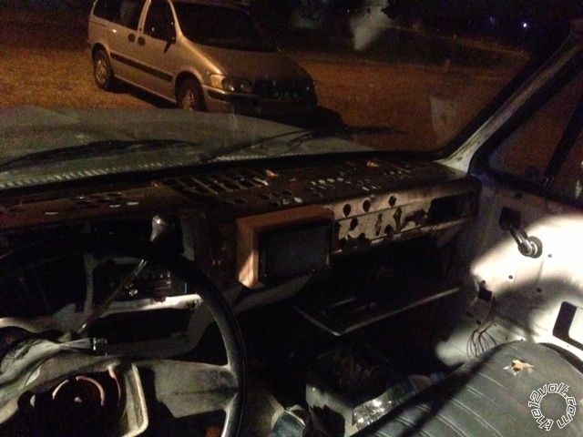

The rest of the photos are me just making sure it will fit in once I cut out the spots in the dash that is part of the cab. I used one of the AC vent holes as where I wanted the head unit and just cut out the whole area so the unit would like right in.

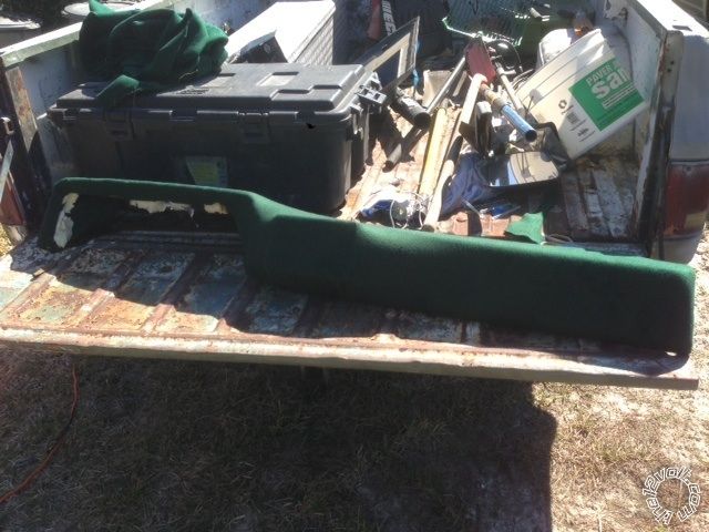

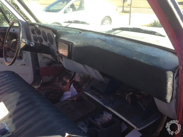

Today I spent about 2 hours wrapping the fleece around the frame and glassing it. here are the photos

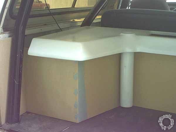

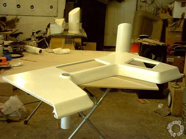

True fabricators are few and far between. A lot of years ago I did an install for a customer that your project reminded me of.
Amprack
Amprack in horrible messy shop. It took me many years to learn to keep a clean shop.
The project that I am working on today at my present shop.
86 Chevy C20, Fiberglass Dash and Doors - Last Post -- posted image. 86 Chevy C20, Fiberglass Dash and Doors - Last Post -- posted image.
It looks like you have a lot of talent. Of coarse a lot has changed since I did this install. Double DIN head units didn't exist back then. I like your plan. The lesson that I learned during my install was the importance of actual glass near the surface of a project like this. Fleece, resin, and body filler are not structurally stable and will crack and distort. Sun, humidity, and shrinkage from the polyester components curing can cause trouble on a project like this with large spans of fleece.
My advice is to cover your project in fatmat after fleece and before body filler. Then cover in thinned filler 1sq.ft at a time, and shoot the whole thing with evercoat polyester primer. This will give you a dense, stable piece that will withstand UV, high temps, and humidity for years to come.
Keep up the great work!86 Chevy C20, Fiberglass Dash and Doors - Last Post -- posted image.
