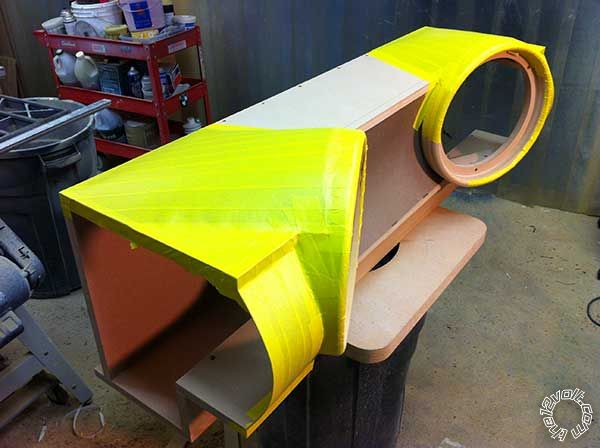

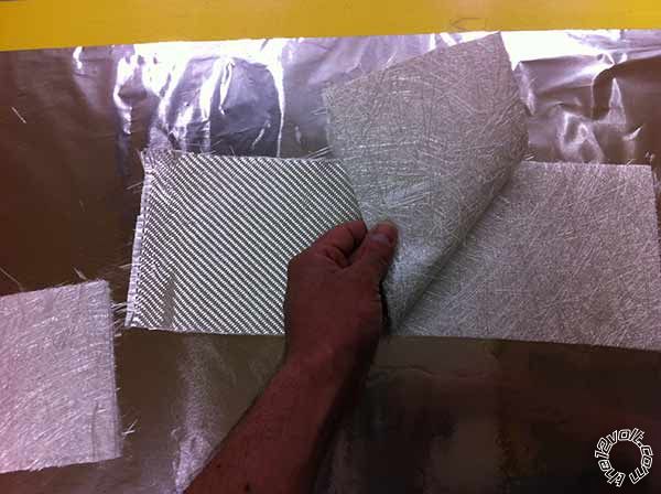

I guess there have been a few points of confusion on my original post.
    What Fatmat is
    How I use chip board
    How this technique saves you time sanding
When I refer to Fatmat I am not refering to the sound deadener product. Fatmat is a term used in large production fiberglass industries like boat building and hot tubs. Fatmat is a technique where you pre-layer modified twill with random chop mat using solvent based spray glue. This allows you to apply resin to the fiberglass before putting it on your project. Doing it this way also allows you to roll out any excess resin giving you the perfect resin to fiberglass ratio for an ultra strong and light wight product.
New Glass Technique - Page 2 - Last Post -- posted image.

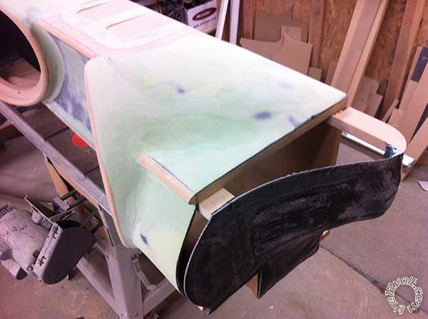

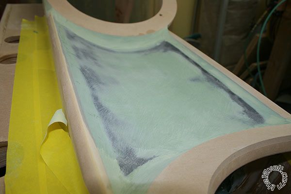

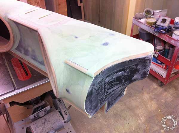

Yes I remove the chip board. I tape and wax the chip board before I lay glass on it. I then bond the glass back onto my project. My projects are much lighter weight and much stronger than you will typically find in the car audio world.
This technique saves you time sanding. Because the glass is preformed and rolled smooth. The final layup requires much much less body filler and consequently sanding. As an added benefit the project has dimensional stability. It won't warp in the sun and there is not much filler on it so it won't shrink and show sand lines through the paint work a couple of months down the road.
