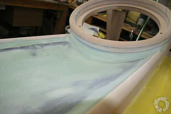

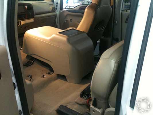

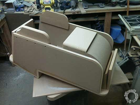

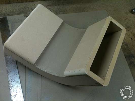

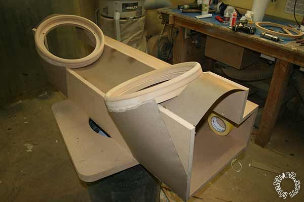

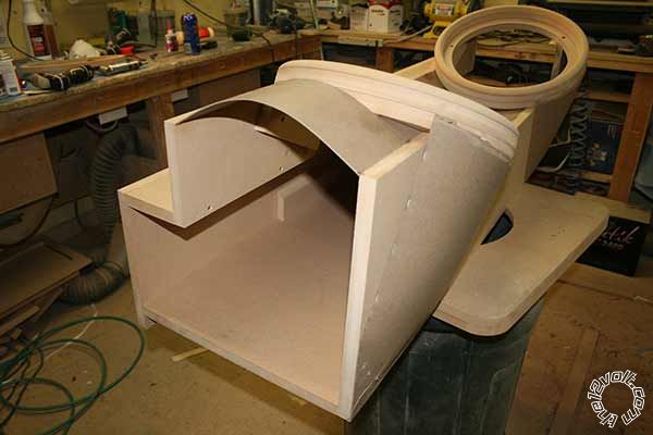

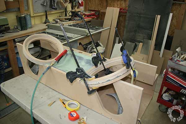

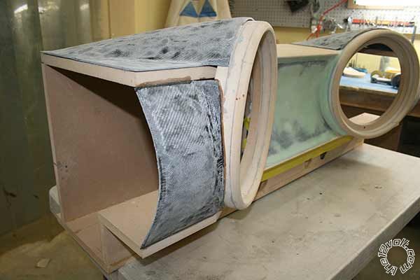

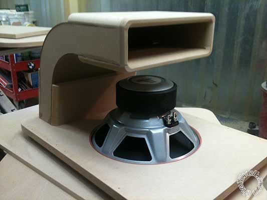

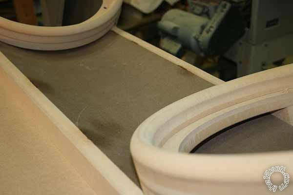

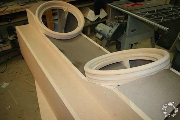

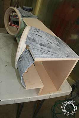

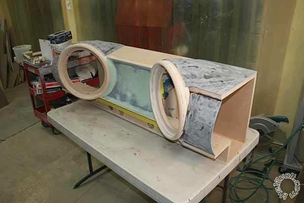

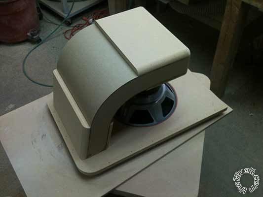

I was attempting to explain a glassing process that I have been using for a number of years now to a friend and realized that not many fabricators are using it (at least to my knowledge). So I thought I would share here and see if anyone has any twists to add to it.

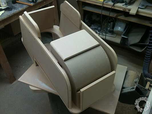

I start with an MDF skeleton (nothing new here). I then wrap a thin cardboard (known as "chipboard" in the upholstery industry) around the parts that I want to glass.
New Glass Technique -- posted image.

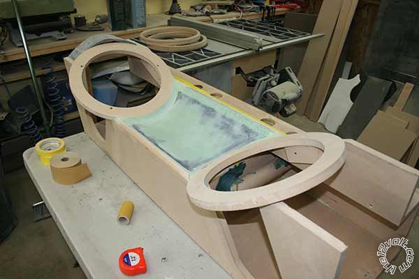

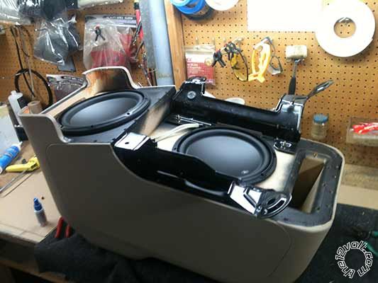

My favorite part of doing it this way is that there is vert little glass and filler to be done on the surface. The back of the chipboard can be reinforced if need be.
Complex shapes that would normally require expensive and time consuming foam can be made this way.

I have found that if you rabbit a grove into the edge of the MDF for the chipboard to sit in you get a nice smooth transition that will need very little effort to glass over seamlessly.

Notice the black fiberglass showing through the green body filler (I use black glass). This is due to the surface being so close to perfect that only a thin layer of filler is required.

When you ask for chip board at an upholstery shop or upholstery supply they will generally give you three options: waterproof board (black 3/16" treated cardboard that is used to make door panels on classic cars), and two thicknesses of true chip board (thick and thin. I keep both thicknesses of chip board in stock at all times but use the thinner of the two the most. I don't use the black water proof board at all. Chip board sells for $1.50 or less a sheet.
All areas that I use chip board on are then covered in aluminum foil, waxed, and then glassed over with "fatmat". I then remove the entire sandwich, peel off the chip board and aluminum, and bond the new fiberglass piece back in. When I am done the structure is strong enough to support a Mack truck. I am quite particular about how strong my glass work is. :)
You will notice the cross pattern on the surface of my glass work. This is because I use a well thought out series of glass grades, layers & application to achieve a high strength to weight ratio as well as dimensional stability. I am a big believer in over building everything, though my techniques allow my final glass areas to be much denser, stronger, and thinner than you will typically see.
