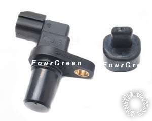

This is an output sensor 2008 Sonata 3.3
It's 3 wire with 12 Volts going into it and one pin ground and one sensor.  Will I damage it if I bench test by applying 12 volts, then ground and hook a meter to sensor output and ground?  Is this a magnetic sensor and will a magnet produce anything to confirm?  Test in AC?
If I had this back in the car would I  jump the sensor wire and put it in drive?   Meter on AC?  (I put the front bumper against a wood pile and jack it up and use 4 jack stands.)
Getting way out there, can I meter test the output sensor pin on what appears to be the output cable of what I beleive to be a control module, bolted to the air cleaner.  Can I fry anything just probing improperly?Thanks for viewing!multimeter wizard? - Last Post -- posted image.

It should be fine. It should be a typical open-collector output, ie the output is to GND else it isn't, and damage should only occur if the +12V supply is not on its correct terminal, or you supply too high a current to its output.
And to test an OC output, use a high-ohmage resistance else diode-test range, or add a pull-up resistor (say 10k) if testing voltage.
In circuit, just measure the voltage. It should change toggle between ~0V and some +ve voltage eg, 3.3V, 5V. 12V etc.

Thank you very much. I have a minimal knowledge of meters. Might I ask, if I am testing the output of a sensor in circuit do I set meter to read AC or DC?
About bench testing, do I hook up pwr and ground and then check output with red meter probe to signal wire and use common ground? I use resistance to check for output signal?

As it is a DC sensor use DC on your meter. You should not see an output under normal conditions and the output should switch on when you place a magnet near the sensor head.
The only way it would benefit you to measure it on AC is if the sensor is switching on and off too quickly to read as a DC voltage. The issue with setting the meter to AC is that it won't actually tell you anything valuable - just that there is something on the wire.
