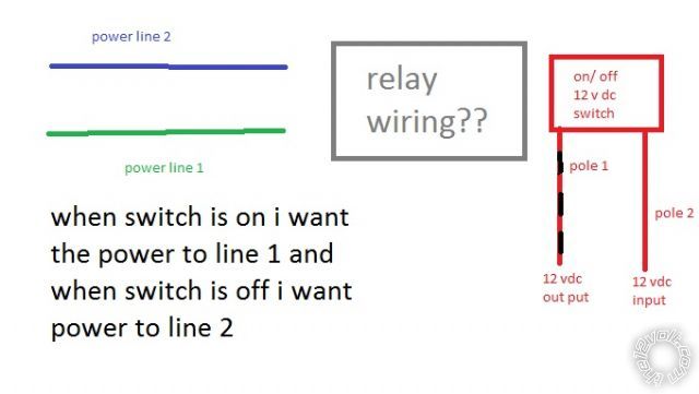

ok so i have used diagrams in this site a few times and really love this site. im no pro but this site has really helped me out on other projects. but i need a little more detail this time. so this is on a 2006 lincoln navigator. im installing an easycar e8 system with push button start. instead of cutting the stock ignition wiring and routing it to the alarm brain i want to route it to a switch, toggle type, on/off. so i think i need a relay so that when i use the toggle "on" will use the alarm system and push to start, but if i flip it "off" i can use the standard ignition with key and bypass the alarm. i know which wires to tap, and to bypass but in not sure how to make an interface for this switch. wire a relay to switch from one source - Last Post -- posted image.
solareclpse2000
Joined: May 18, 2013
Posted: May 18, 2013 at 4:04 PM / IP Logged
oh also the "bypass" switch will be mounted hidden in the engine compartment. its really just in case the alarm fails, or start button breaks or something, so that i will have a backup option to just use the key and start it normally with no alarm so im not stranded. the " line 1" for example would be the power to the alarm brain. and the line 2 would be the feed to the stock ignition switch. if i can give more detail or am not clear enough please let me know

I'm only responding to the "switch on the #1 on & switch off #2 on" statement.
I'm ignoring ALL other text.
You have just described an SPDT relay. ie,
85 GND
86 switch output
30 common (ie, +12V supply, or line out)
87 line 1
87a line 2

thats all i needed to know thanks. i know i saw what looked like a farily easy diagram for the spdt in the relay section. i just didnt know which line would go where. i dont quite understand how relays work entirely, even after looking into the section on here for it.
