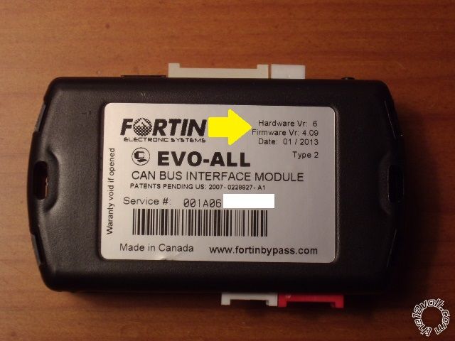

The Fortin bypass module was chosen for several reasons. The comparable bypasses ( DB-ALL and ADS AL CA )
both require a firmware load specific to the vehicle using a special USB flash cable ( and dealer access to the WEB
site in the case of the iDatalink ADS AL CA module ). The Fortin EVO-ALL should come loaded with the most current
firmware making it very DIYer friendly. For this install, an EVO-ALL with a minimum of firmware V4.09 and Hardware
V 3 is required. This should not represent a problem if purchased from a reputable dealer. Just beware of "online
auctions" selling old, out of date modules. Below is a picture of the EVO-ALL with the H/W and S/W version location
on the manufacturers sticker marked. ( This indicates the S/W version that was loaded during manufacture and can
be changed by anyone with a Fortin FlashLink cable ($60 ) and a PC with internet access.)

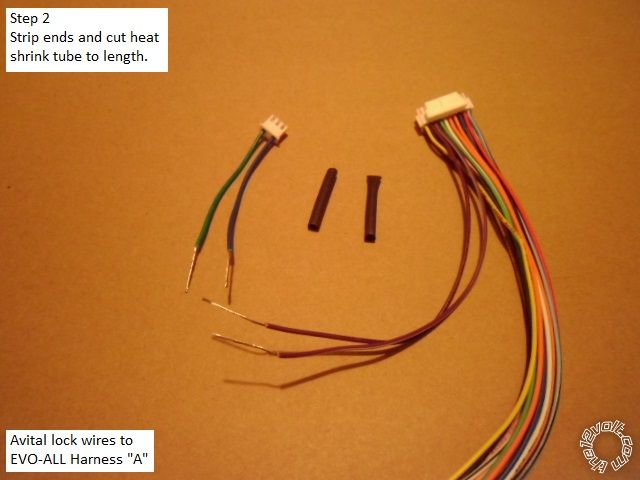

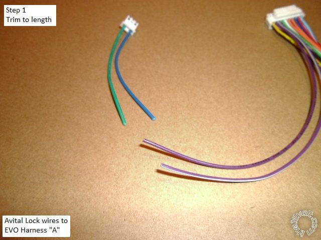

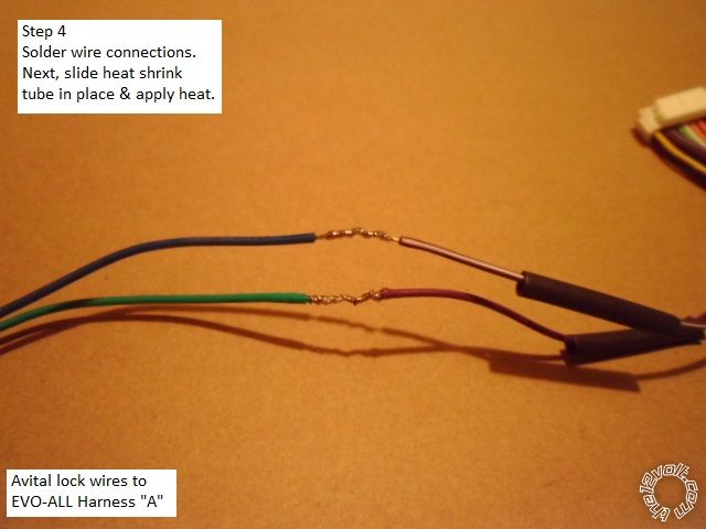

Making all of the necessary wire connections between the Avital 4113 and the EVO-ALL on the bench, under ideal
conditions, will make for a reliable system and an easy install. Out of the box, the EVO-ALL is not D2D compatible
with the Avital remote start unit. Therefore, the interconnections were done with the W2W method. While it does
consume more time, the results will make it worthwhile. Using the W2W method will allow the EVO-ALL to work
with any brand / model of R/S system.

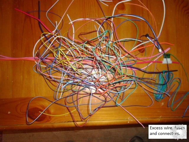

There will be more wire left-over from the actual vehicle install as each wire is wire, located, secured, cut to length
and soldered. While it looks like a daunting task, remember, there will be only seven wire connections to the vehicle.

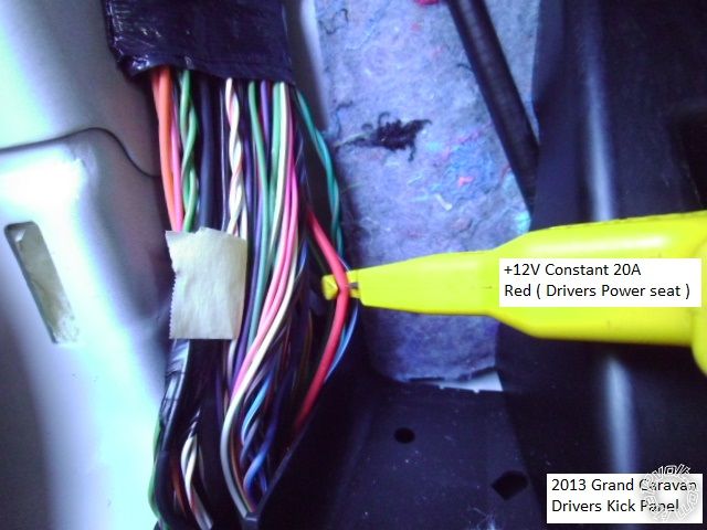

4 RED (+) (30A)      HIGH CURRENT 12 INPUT Vehicle Red +12V Constant in DKP ***
5 PINK/WHITE (+) PROGRAMMABLE OUTPUT FOR ACC OR IGN Not Used
6 RED (+) (30A)      HIGH CURRENT 12V INPUT  Vehicle Red +12V Constant in DKP ***
*** The two Red wires can be joined together and fused down to 10A. The Red +12V source wire in the DKP is for the
driver's power seat. This vehicle did not have the driver power seat option.

Please note that the Avital one button remote can perform an Unlock during remote start run time and can be
useful if the factory key FOB is lost, locked inside the vehicle or the FOBs' battery dies.

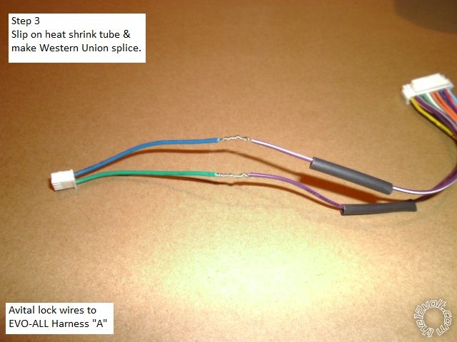

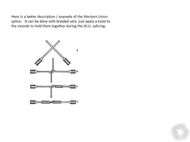

The connections made during bench prep should be neatly trimmed to length, soldered and insulated with heat
shrink tube. Below are photos of some wires connections being made using the Western Union type splice with
solder and heat shrink tube.
2012-2013 Dodge Grand Caravan Remote Start Pictorial - Last Post -- posted image.

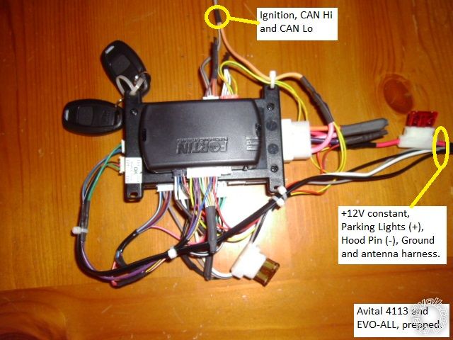

Here is a photo of the completed assy. As mentioned, there are only 7 connections to the vehicle. Three wires
at the ignition switch harness, three wires in the DKP and one wire to the engine compartment for the Hood Pin.
Notice that the wires have been split into the groups that will be routed to the proper vehicle destination. The
Avital antenna harness is included with the DKP group and will continue up to the windshield.
Leave enough slack in the harnesses to allow for the EVO-ALL programming procedure and trouble shooting. The
main power 10 Amp fuse will be removed during installation and not re-install until all the wires have been connected.
Unused wires can be cut, grouped together and insulated / secured with a piece of heat shrink tube.

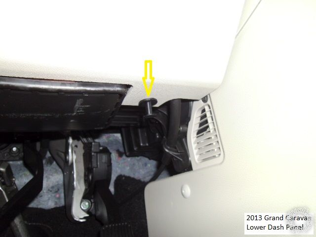

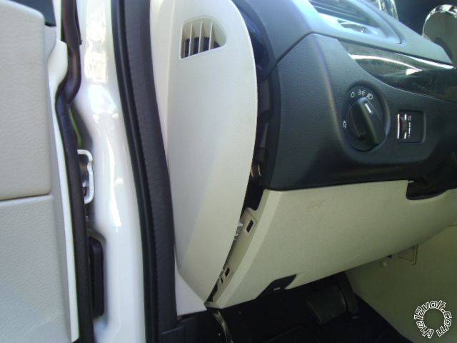

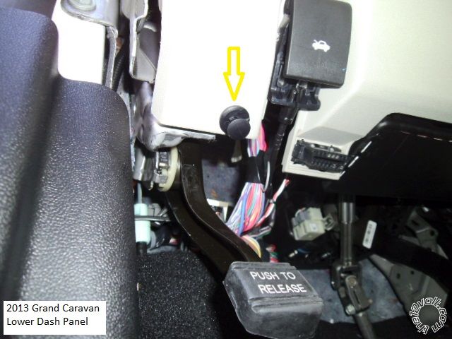

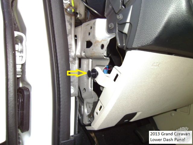

Using a non-marring trim tool, remove the dash side-panel as shown in the picture below.
There are three retaining fasteners holding the side and bottom of the lower dash panel. Using a screwdriver, gently
pull the center section out, then remove the remaining outer piece. The pictures below show the popper locations.

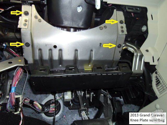

Remove the knee plate / air bag assy by removing the four 7mm machine screws shown. Do not unplug the
airbags' yellow harness, just rotate the assy and rest it against the center console.

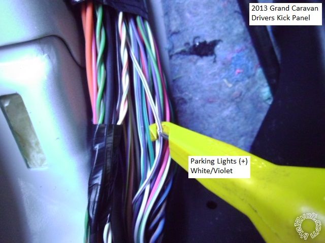

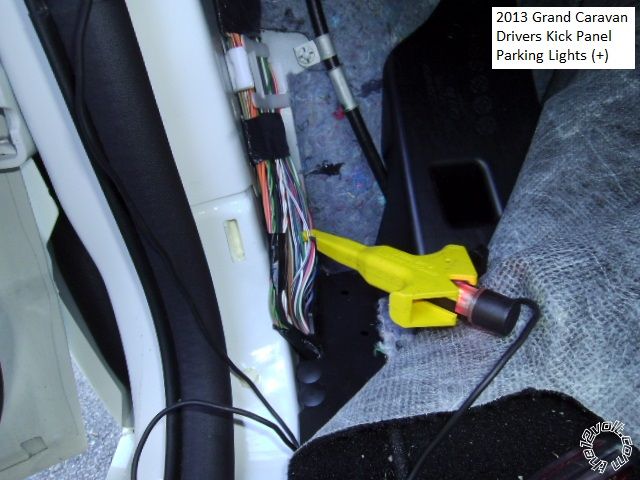

These photo's are of the Parking Light wire in the DKP.

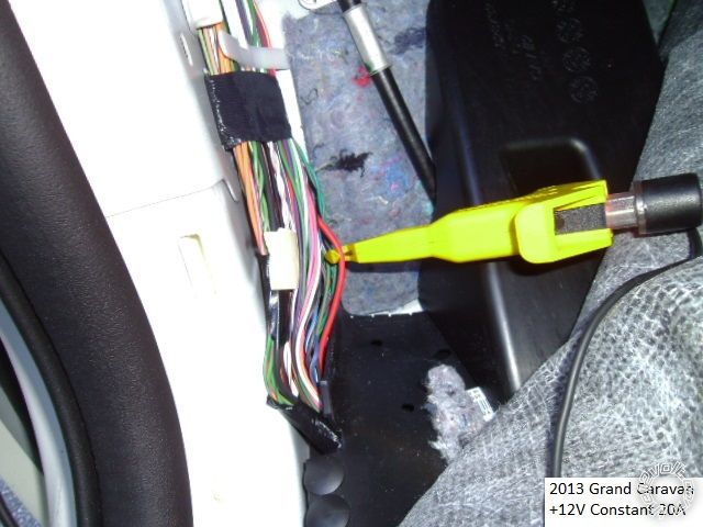

This is a shot of a convenient +12V constant source in the DKP.

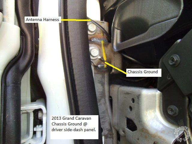

This is a picture of a convenient, solid chassis ground point in the driver side-dash area.

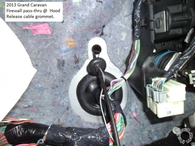

Here is photo of a firewall pas-thru for the Hood Pin wire.

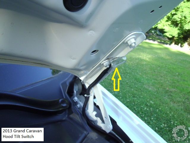

The Hood Pin switch is an important safety feature. All R/S kits include a hood pin, however, depending on the
mounting location, they are prone to rust and fail with in a year or two. Pictured below is a more reliable mercury
tilt switch.

Light wire and the main +12V power wire were extended to allow for neat routing to the lower driver kick panel
area.
After all wires are properly connected, verify that all EVO-ALL connectors are unplugged, then insert the main
power fuse(s).   Follow the EVO-ALL programming procedure.   Next change the Avitals' programming to Tach
Mode and preform the Tach Learn process. The rest of the Avitals' programming options will work OK in their
default setting.

If adding a remote start with alarm system and keyless entry, the EVO-ALL will supply the door and rear hatch
status signals and allow the R/S system to control the locks, sliding door and hatch ( when wired correctly )
A van with the Factory Alarm will require a R/S system that can be programmed to Unlock the doors, remote start
the engine and then re-lock the doors. This will disarm the alarm and prevent the horn from beeping. Another
way to achieve this is with an EVO-ALL programming option using the Fortin FlashLink programming cable.   There
are other methods but that would go beyond the scope of this DIY pictorial.
With the Fortin FlashLink programming cable the EVO-ALL can be set-up as a stand alone R/S unit. This will eliminate
the need for the Avital 4113 but does require the FlashLink cable. The downside you will be using the Factory FOB
and three Lock commands to remote start the engine. This limits the range and causes the horn to beep with each
lock command. Addition parts will be required for this type install ( relay for the Parking Lights and a Hood Pin switch ).

Here is some more information on the "tilt switch".   They are best when used for a non-alarm installations due to the
distance the hood has to be raised before it triggers. They are sold by several manufacturers under various designations.
Directed = 8613 and 8623
Omega = AU-46
Mobilistics™ Negative triggered Mercury Switch
Code Alarm Roller Ball Contact Tilt Switch TL200
When mounted to the hood support hinge bolt, it is quick with no holes to drill or future rust to worry about.
Below is a diagram of the Western Union wire splice method. It is good for butt splices and provides excellent strength
& connection reliability.
