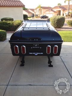

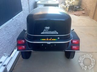

Thanks for getting back to me. My trailer is a small camper that I pull behind both my car and motorcycle. Both tow vehicles have 6pole square connectors. I have another small cargo trailer configured the same with the 6 pole.
I don't believe rewiring the trailer to fit the 6pole would work because there is only one set of tail lights. All of my prior (and current) trailers have come from the factory with two sets of rear lights (a usual occurrence for small motorcycle trailers) and a 6pole connector. So, in order for me to keep commonality with my tow vehicle connectors I have to have a second set of lights installed... unless I can somehow figure out how to use relays to accomplish with two dual filament lights when I would normally have four to work with.
getting power to my trailer brake lights - Last Post -- posted image.
Factory installed dual set of lights
The two lights at the top are the ones I need to work with.

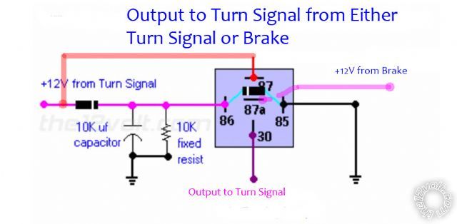

ecadee
Joined: September 30, 2013
Posted: October 03, 2013 at 7:57 PM / IP Logged
davep
I just want to make sure of what I think I know.
Does this look right to you?
Do I need a fuse in line with the brake wire? If so, how big?
What are the black with white stripe rectangles?
You are what you do.
davep.
Gold - Posts: 649
Joined: May 27, 2011
Posted: October 03, 2013 at 11:32 PM / IP Logged
That looks good. Exactly what I had in mind.
The "black rectangles with a stripe" are 1 amp diodes. They are one-way valves for electricity. Current flows in the direction of the band towards negative. You can get a pack of 5 at radio shack for a few bucks. When you find a store that has the capacitors, they will surely have 1A Diodes too.
You must use the diode on the input to the Resistor/Capacitor network for the coil, so the R/C network doesn't flow back into the circuit when the signals blink off.
The diode across the relay coils is for "anti-spike". I am not certain why the author of this diagram included it in this circuit. But it won't hurt anything, so put one there too.
The brake light circuit should be fuse protected somewhere in the towcar, so an additional fuse is not necessary for circuit protection. If you add a fuse at say the trailer connector, or the brake input to the relays, then a short in the trailer lights would blow the new fuse, and the tow car brake light would remain functional. For this to work, the new fuse has to be smaller than the tow car brake fuse.
Personally, I'd trust my wiring, and the towcar's existing protection. Familiarize yourself with where the fuses for the trailer lighting are. Particularly on a road bike like a Harley.(If that's what you have). Learn where the fuses are at your convenience, not when you're in a hurry to find a blown one and can't get the seat off.
