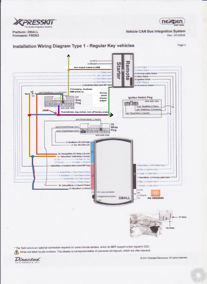

Try this;- 2012 Should have a grey plug on the BCM, C7 Lock and deadlock, pin 6 yellow/grey, (-), pin 19 PURPLE / brown unlock and turn off factory alarm.
That's the case on UK models up to 2014 have a look and let me know if the US version is the same.
Posted: May 20, 2015 at 5:47 AM / IP Logged Link to Post Post Reply Quote howie ll
This is the Euro version using DB-ALL2 with my mods giving you regular lock and unlock with ignition and deadlock + factory alarm with alarm on, unlock and factory alarm disarm with alarm off.
You don't really even need the DB-ALL or similar it can be hard wired but take care, door hood and trunk/hatch triggers are normally closed, the DB and similar gets around that problem

All the Euro versions had the locking system I told you about up to 2014.
The US version should be the same, they're all made in Spain.
Let me know if the wires of the colours I mentioned are in the plug.
