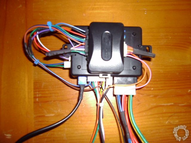

I like the idea of "keeping it simple".  Using products from one manufacturer / supplier is a good idea.  For the professional, having
the necessary USB bypass module flash cable ( XKLoader2 for DEI, ADS USB for iDatalink and FlashLink for Fortin ) isn't an issue,
just a one-time purchase of an important tool.  For the DIYer, the extra $40 to $90 per cable could be prohibitive.  Now-a-days, almost
every bypass module has to be flashed prior to use.   We all have our favorites, usually a product you are familiar with that has
performed well.   iDatalink is my go-to bypass module, with Fortin a very close second.
Just one more thought.  As mentioned by Ted, some of the entry level R/S systems have some difficulties with D2D.  They are getting
better but...    Aside from Tach and Brake issues, the 4103 can have ESP BitWriter / DBI D2D port function problems.  Some units
are shipped with the port set to ESP BitWriter and need to be manually switched over to DBI D2D mode for proper operation of the
D2D data connection to the bypass module.  Due to those issues, if I am using a full featured bypass module ( one that performs
more functions that just transponder bypass ) and an Avital 41x3 unit, I go W2W between the modules.  While it is time consuming,
done on the bench during the prep phase, it can be done neatly, is very logical and always works 100%.  No post-install / testing
issues and no come-backs.  If you have the time, going D2D could work OK and you can always revert back to W2W if necessary.

Remote start unit and ADS DL bypass module bench-prepped in W2W mode :
2014 Honda CR-V, Avital 4103lx - Page 2 - Last Post -- posted image.
