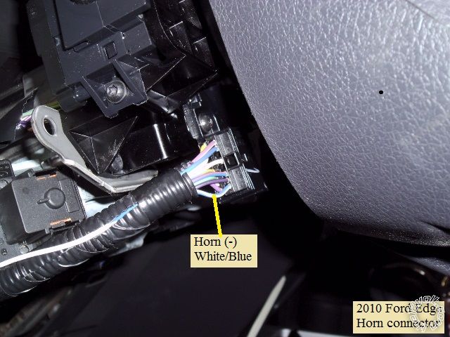

** While all the wiring guides listed the Horn wire as Blue/White, it sure looked WHITE/ Blue to me.  There is a Blue/White wire in the
    connector, so cautious testing with a DMM is necessary.

The horn wire is shown below :
2009-2010 Ford Edge Remote Start Pictorial - Last Post -- posted image.
