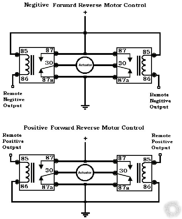

This is basically what you're doing with my above suggestion. You will have the two actuators in parallel:
Polarity sensing 12VDC relay system - Last Post -- posted image.

Posted: June 16, 2015 at 8:57 PM / IP Logged Link to Post Post Reply Quote hotwaterwizard

Thanks hotwaterwizard. We were talking here about a negative switched circuit here too. Not sure which Ill use. Did not get to install this yet-kids graduation party, household stuff etc
