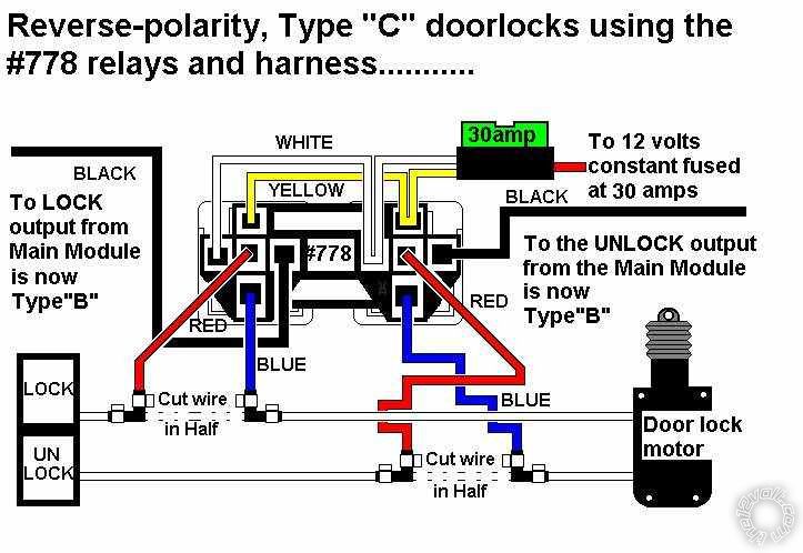

Door Lock, 3 pin connector:(do I connect straight into the wires or do I have to run thru a relay? If relay is used, can anyone point me to a "how to"? I believe this is a 5 wire reverse polarity)
(-) Unlock....pink/purple (reverse polarity)
not used
(+) Lock....ORANGE / purple

Viper 4105V to 1996 Dodge Diesel-Remote Start - Last Post -- posted image.
The door locks
