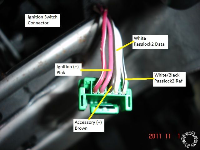

One last thought.  The install guide diagram shows that the PK3 Immobilizer connector has the RED / White wire cut.  That wire is not on the same connector as the ignition wires.  Here is a photo of the Green main ignition connector :
Viper 5706v won't start my 2010 Chevy Malibu - Last Post -- posted image.
This connector has a RED / White wire that will test as +12V but it is not the one that needs to be cut and connected to the DB-ALL2.
