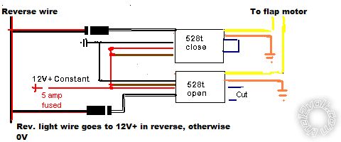

Here's a simple way to do this. Use the reverse (back-up) light feed.
This wire sits on ground, when reverse is engaged it goes to 12V+.
Use a pair of DEI 528t adjustable timer relays, just add 1/2 second to the normal open/close times, no microswitches required.

I found some of those timer relays online, they're a bit bulky for my installation. I was wondering if latching relays, or polarity reversing relays could be used instead... Also, the micro-switches would be on the motor bracket and I've already allowed for that (if need be).

Posted: September 17, 2015 at 7:58 AM / IP Logged Link to Post Post Reply Quote howie ll
Then use normal relays and microswitches.
