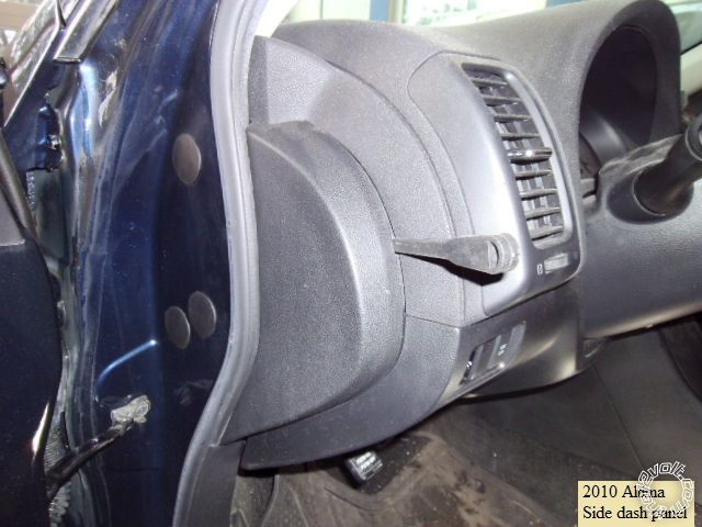

Remove the side dash panel using non-marring trim tools, as shown below :

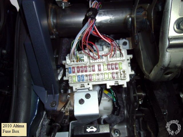

Remove the lower dash fuse box access cover to expose the lone panel retention screw.  Photo below :
2009-2012 Nissan Altima Remote Start Pictorial - Last Post -- posted image.
Remove the indicated screw and then pull the lower dash panel straight back and away.  There are several plastic clips

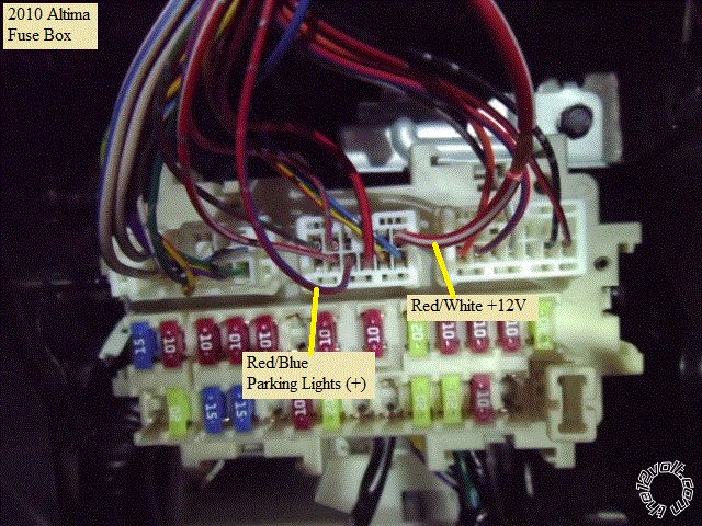

This is a photo of the drivers fuse box :
Here is a close up of the needed wires in the center plug :
The +12V wire shown can handle the Viper and ADS AL-CA current needs and should be fused at 20 Amps or less.

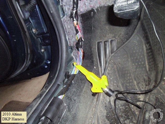

This is the driver door sill harness :
Also, low in the drivers kick panel is a factory ground point that can be used as Chassis Ground for the R/S system
Remember to use a soldered on terminal ring in the appropriate size for best results.

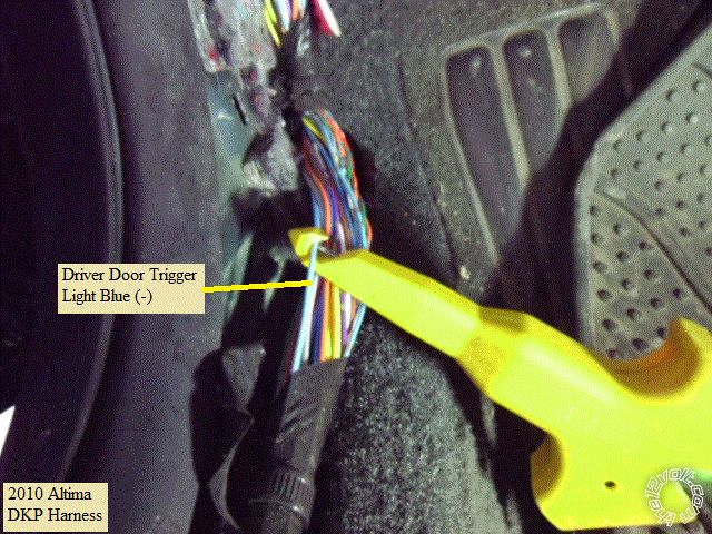

Here is a close up of the Driver Door Trigger wire :

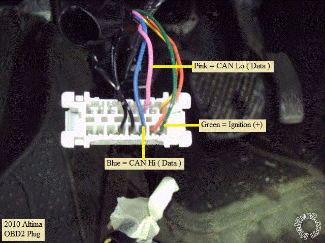

This is a photo of the OBD2 plug, also found on the removed lower dash panel :
