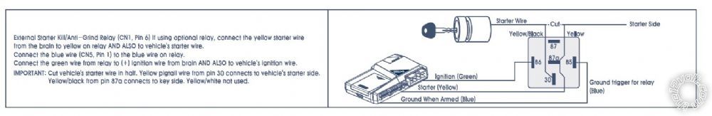

The instructions are pretty straight forward and include this diagram...
Wiring 2015 Accord Sport, Compustar - Last Post -- posted image.

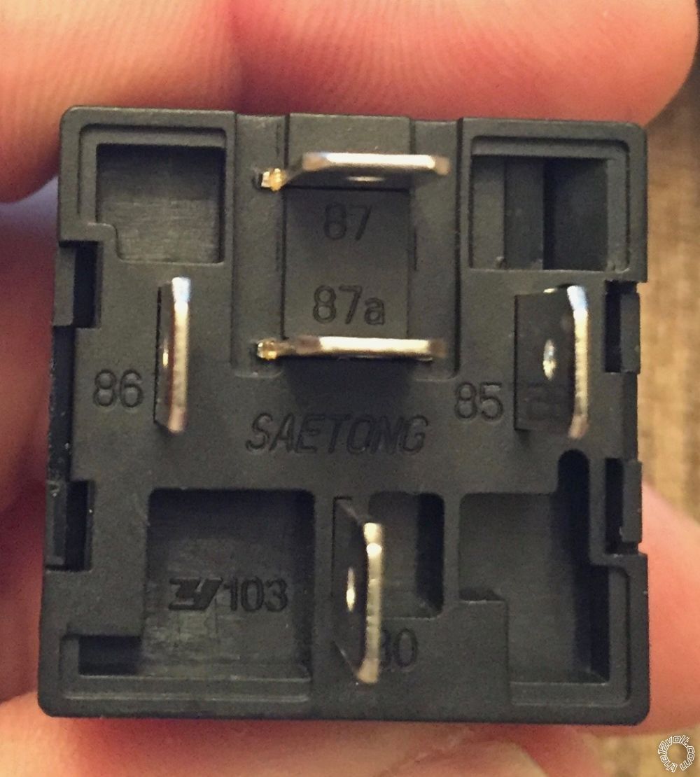

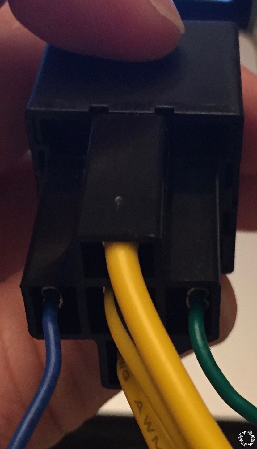

As you can see it shows 86 as the ignition/green wire and 85 as the ground trigger for relay/GWA blue wire from the RS. HOWEVER, when I compare the actual relay that was provided it appears these two have been switched. Am I imagining things? It seems that this flys in the face of conventional wisdom; however, I did just complete a 13 hr flight and probably shouldn't be tooling around with this stuff right now...

Yes, it is different from drawing but does not make a difference except for debugging purposes. 85 and 86 go to the coil that activates the relay and can be reversed without issue.

It actually doesn't matter. A relay like this will activate with voltage on one coil terminal and ground on the other, and if you reverse the connections it won't hurt anything.
Some relays have a diode placed between terminals 85 and 86, and with these relays you'd need to pay attention to the polarity of the connections. Without the diode, they're interchangeable.

Thank you!
I knew that there was something I was missing! I never even looked to see if the relay had a diode...
