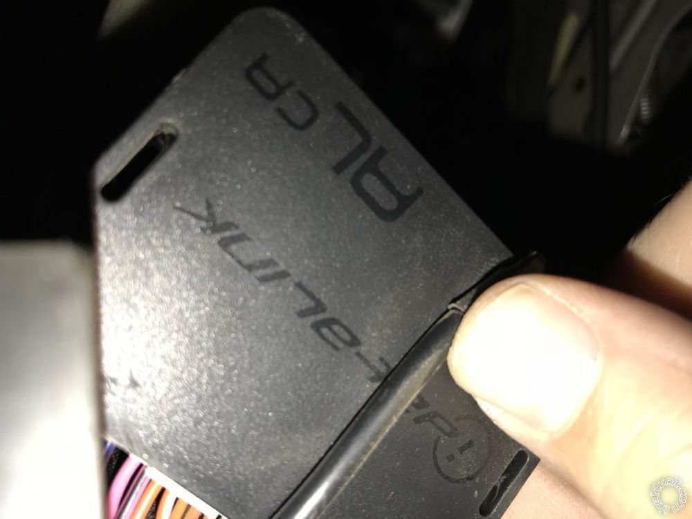

Automate 4114a, 2014 Ram 1500 Issue - Last Post -- posted image.
Added info, looks like we have this as well.
