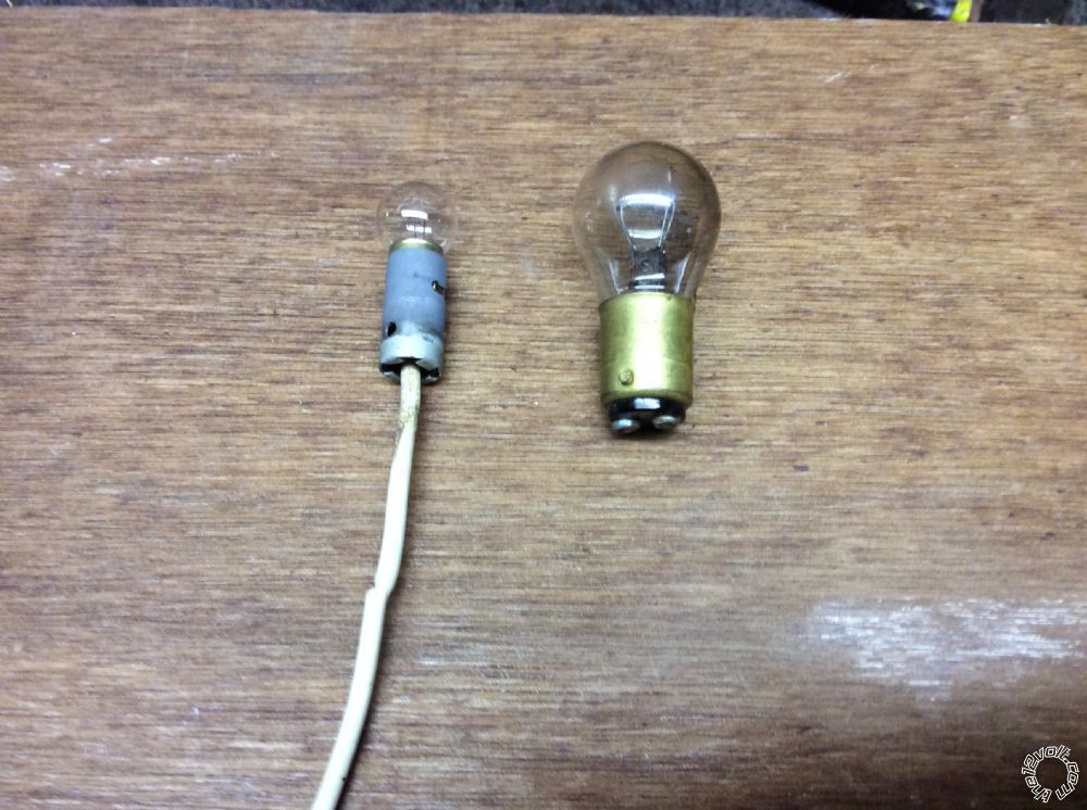

The bulb and socket on the left is what I am trying to convert to turn/parking light. The bulb on the right is a typical 1157 bulb and I do not want to modify the headlight
bucket to accept the larger bulb.

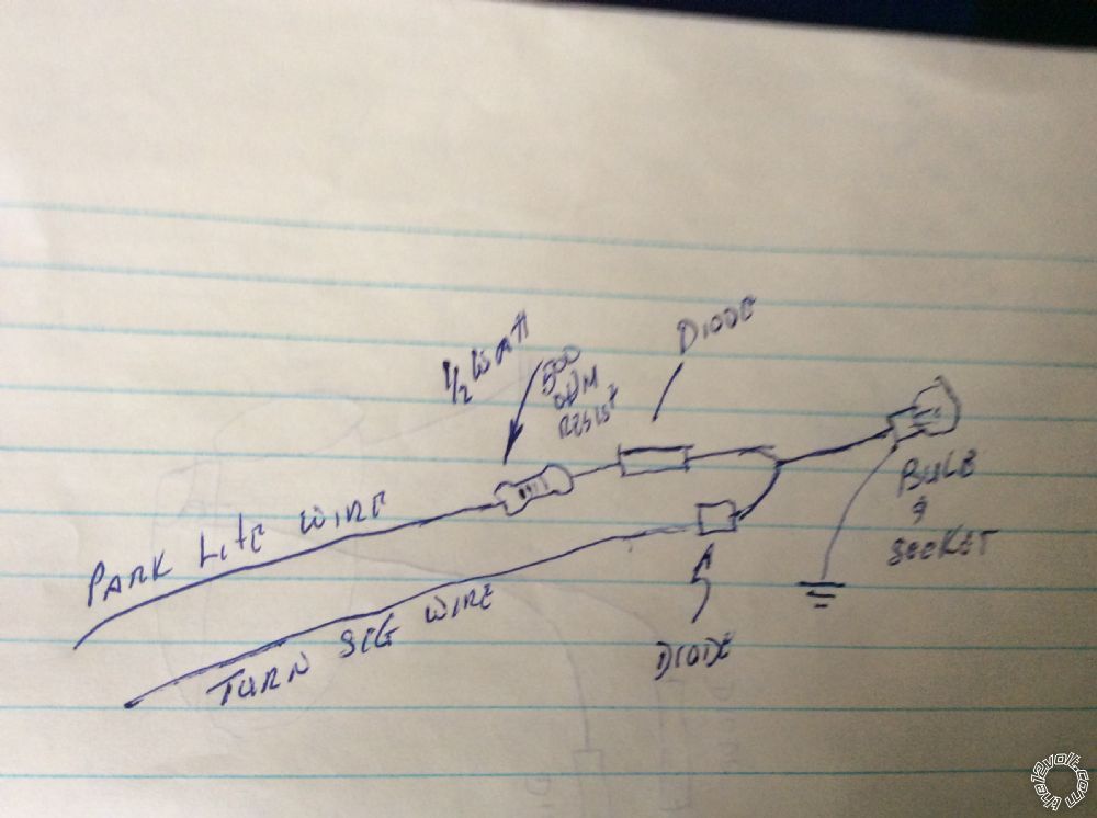

Would it be alright to have the single filament bulb dim for when the parking lights are on but then full brightness when the turn signal is activated ?.
I think it could be done this way with a resistor and some diodes. I had a diagram going but I need to fine tune it and post it as I might not be seeing something that could be incorrect.

I got a diagram for the installation. My question is in regards to DIODES. While shopping for diodes I come across an 18 volt 5 watt Zener Diode and a 3 amp diode and a 1.0 amp 50 volt Standard D recovery diode. WHAT is the difference? What Diodes do I need to complete this installation?

Post the diagram so we can see what is going on with the design and give recommendations.

This is the diagram I have for the installation.
Now what is the difference between the diode description that I posted in my last response
