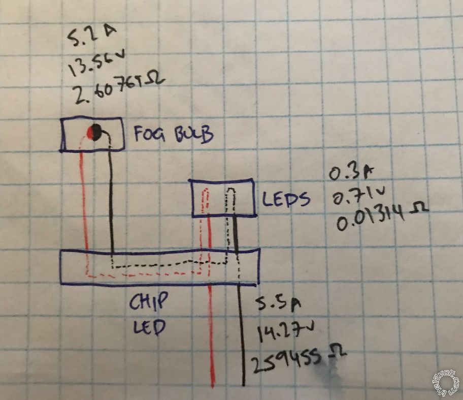

There is some kind of circuit board chip that main power enters, does something, and then sends power to the halogen bulb. Could something in this circuit board be checking for something in the halogen bulb circuit which allows the LEDs to run? I don't think this light is that smart, but it may be since a simple load resistor didn't work. Best guess diagram attached.
I took current and voltage measurements but not sure if they make sense. First I measured current and voltage with both LEDs and halogen. Then measured current and voltage of only the halogen bulb. I think I calculated correctly resistance and power, but not 100% sure. Total power would be 5.5a and halogen bulb only at 5.2a; which means that LEDs consume 0.3a if in series and current is cumulative?

Separating LED and Halogen Bulb Resistance - Last Post -- posted image.

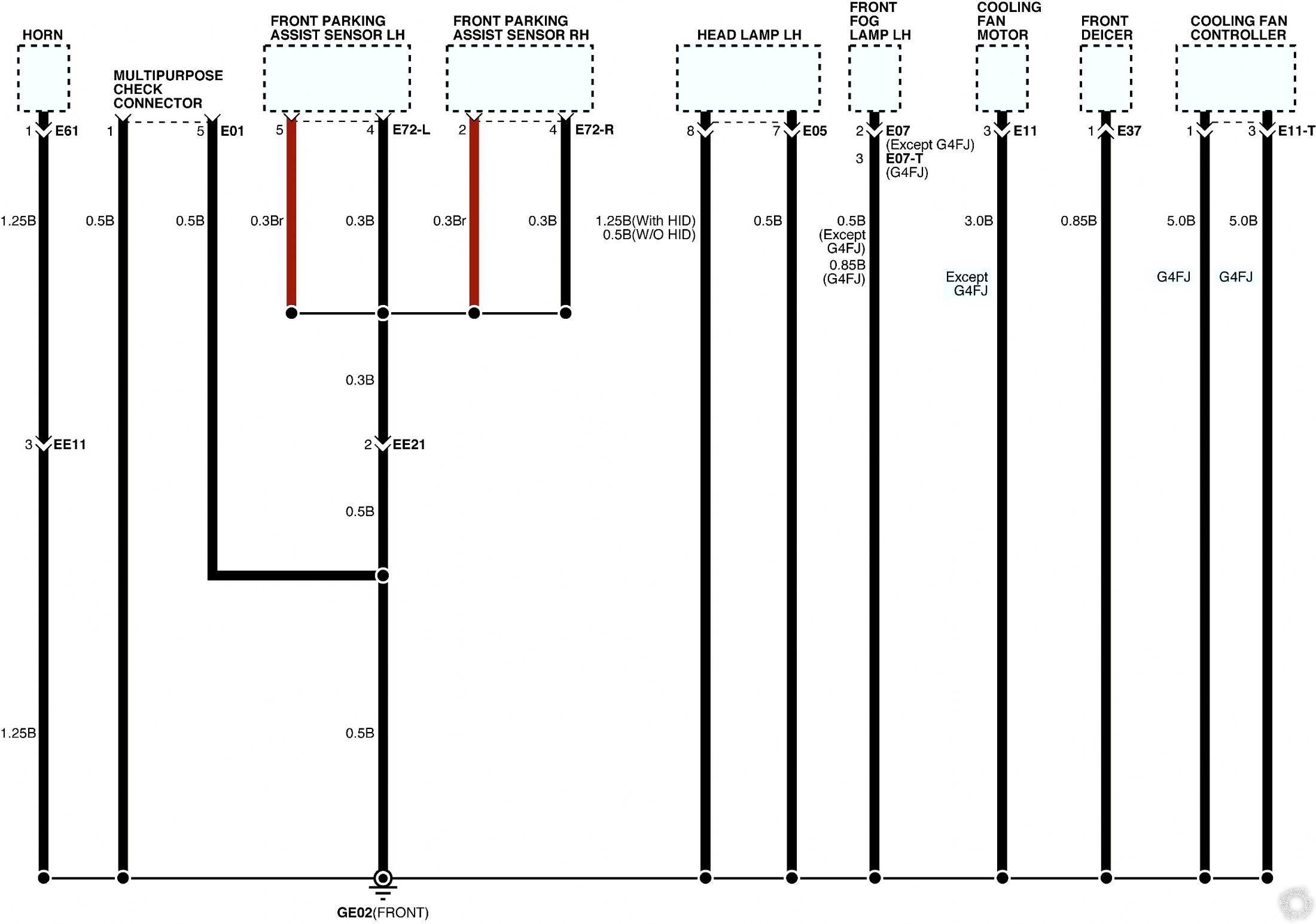

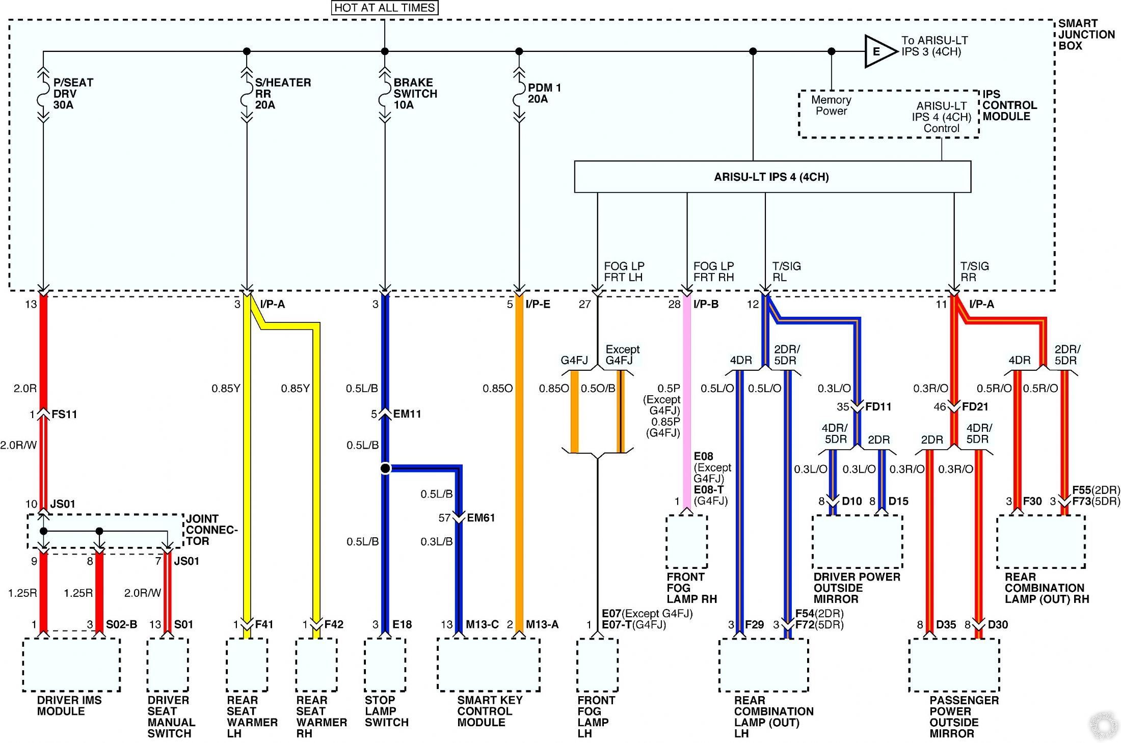

Hope these help

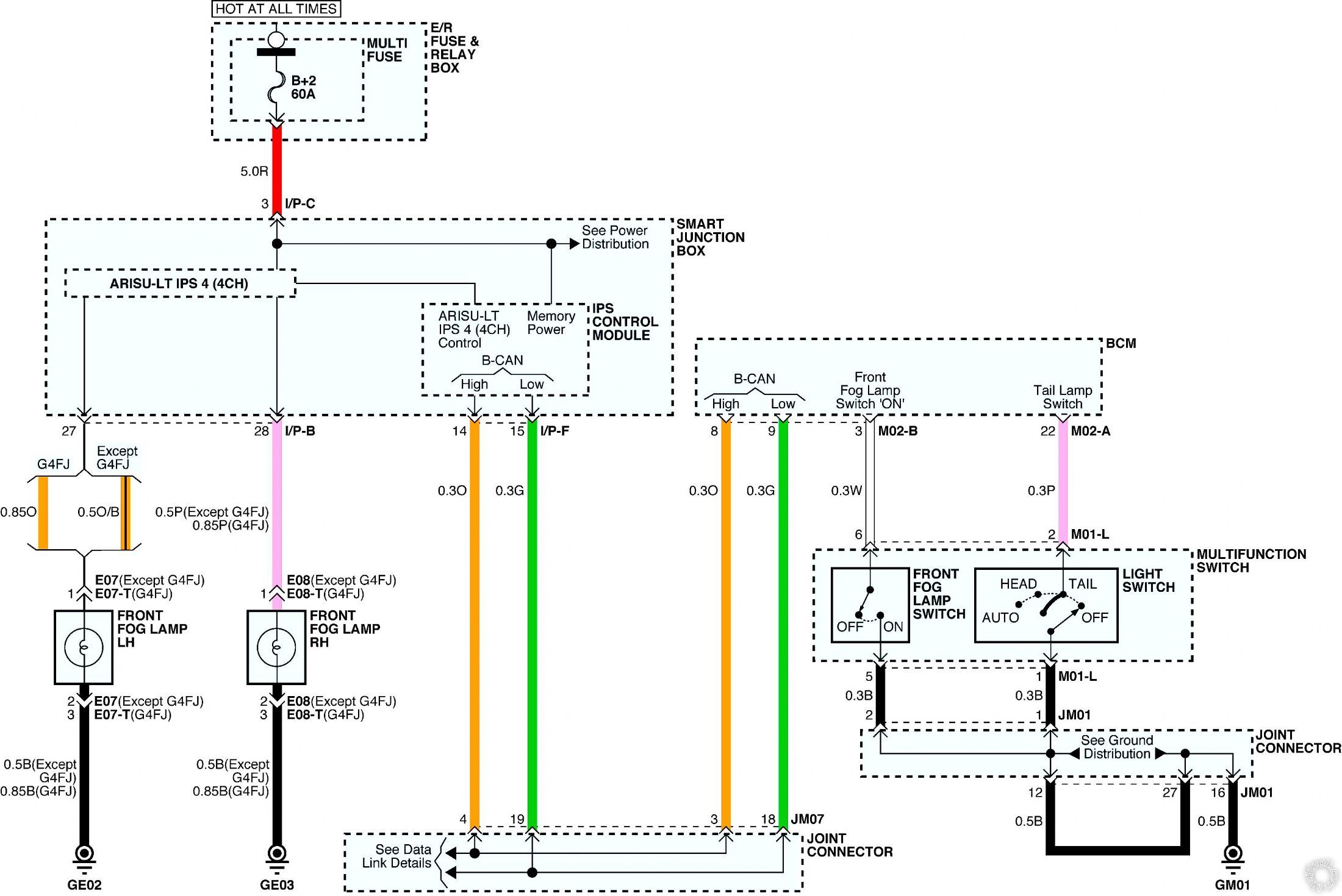

Posted: January 02, 2019 at 1:53 AM / IP Logged Link to Post Post Reply Quote colinn
Hi Gary,
Thanks for the reply. Forgot about this site.
I can tell that that schematic is for my Kia Forte... but not really sure what it means. Feel like there are missing pages or descriptions. Where did you get that? Do you think I'll be able to track it down somewhere?
