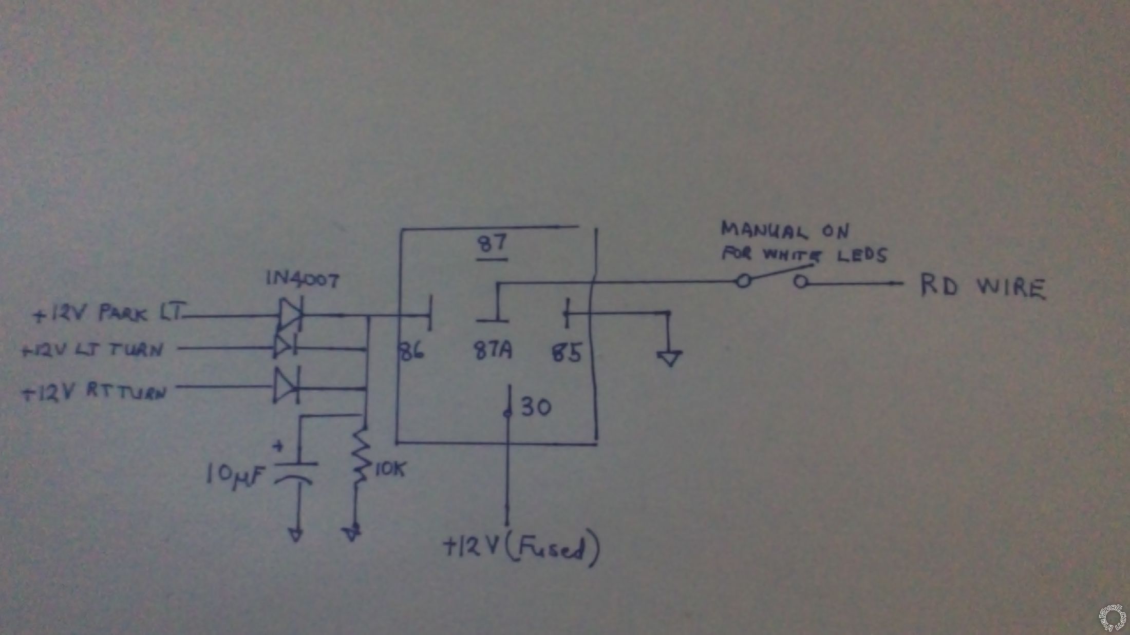

Posted: August 31, 2018 at 8:25 AM / IP Logged Link to Post Post Reply Quote eguru
Try this circuit to disable the white LEDs when either turn signal or the parking lights are activated.LED Fog Light and Turn Signal, '94 Toyota 4Runner - Last Post -- posted image.
4runninin
Joined: August 28, 2018
Posted: August 31, 2018 at 2:31 PM / IP Logged Link to Post Post Reply Quote 4runninin
I will give that a try. Thanks for the suggestion.
