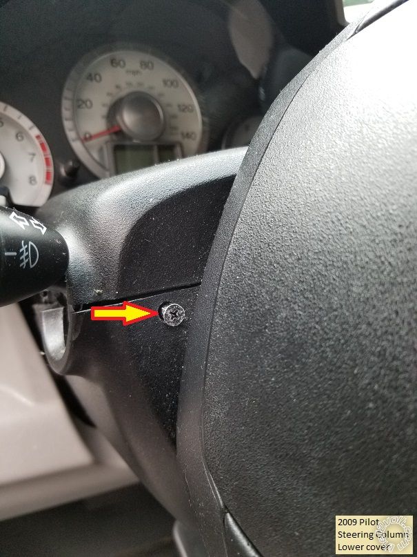

To remove the Steering Column covers, remove the three Phillips head screws at the underside of the
steering column shown below :
2009-2016 Honda Pilot Remote Start w/Keyless Entry Pictorial - Last Post -- posted image.
Next remove the two screws at the 9 and 3 O'clock position by rotating the steering wheel to expose
these hidden screws indicated below :

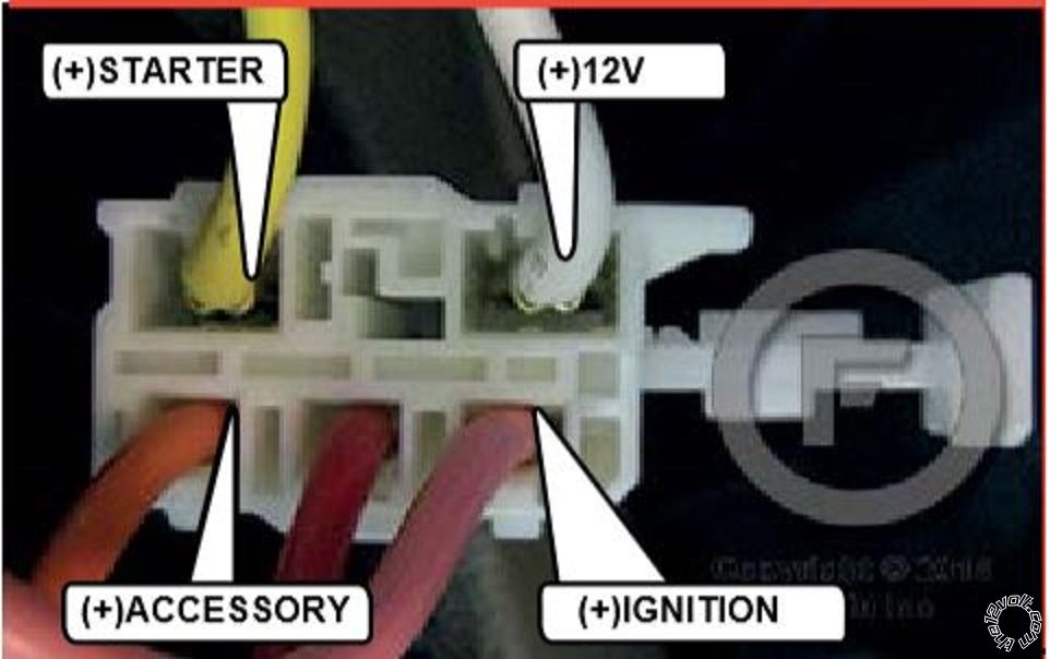

Here is a picture of the main ignition connector from Fortin with the ignition wires marked :
Please note that the Red wire is an Accessory type wire and not needed for this installation.

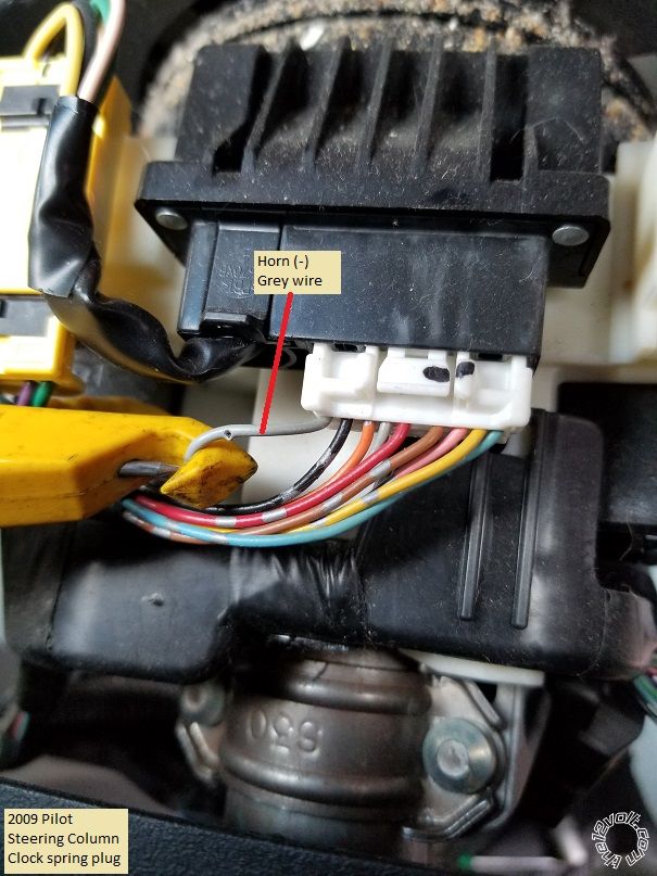

If you want to make the R/S Horn connection, that plug can be found at the top of the steering column.
Here is a photo :
Below is a close-up of the plug with the Horn wire indicated:
