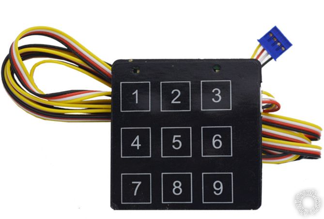

I am using a capacitive password entry keypad to unlock my vehicle if I forget/lose my fob.
The keypad is adhered to the inside of the windshield.

I'll check out Tasker. I downloaded and installed Car DashDroid today. I'm liking the look. Right now I've got USB Cammer (Camera?) and it looks ok. Since it won't be connected to internet all the time, I'm guessing the ads from the free versions will be minimal.
I don't need the keypad for this car, but tell me more about it. Is it Arduino? Something self contained (save for the connection to the locks)? Off the shelf? This car is a 99 Taurus and has the driver's door keypad. I was able to access the code with a program called FORScan and an ELM327 device. I don't know if I'll use Torque Pro or the Android version of FORScan, but it gives me a lot of monitoring, all customizable, from sensor data to using the sensors in the tablet to do a 0-60 time (or set the MPH from and to and it'll measure). A friend, though, might have good use for the capacitive keypad.

This is what the keypad on the inside surface of the windshield looks like. It needs to be interfaced to a microcontroller (not necessarily an Arduino).
