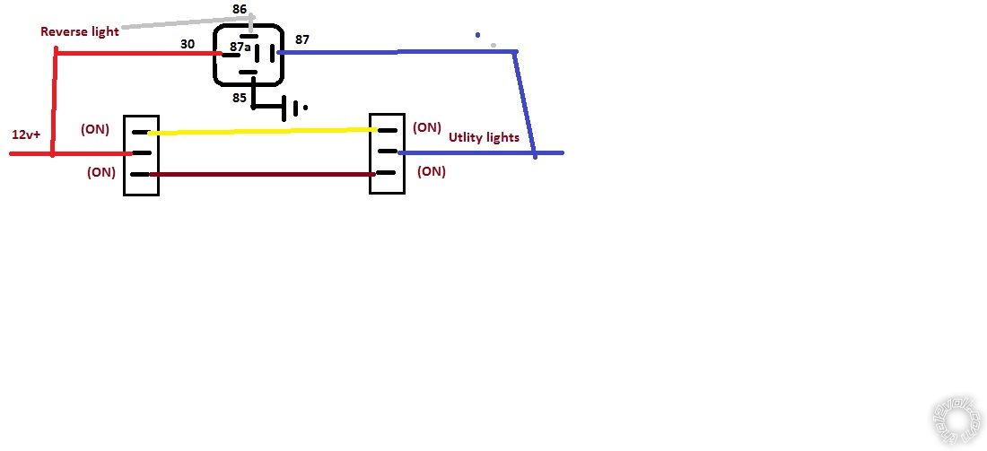

If what you are trying too do is power the lights when ever the reverse lights are on regardless of the 3-way switches position you will need to connect the relay output to the switch that is connected to the lights side of switch
3 Way Switch Powered By Relay - Last Post -- posted image.

Posted: November 09, 2018 at 11:56 PM / IP Logged Link to Post Post Reply Quote geepherder
Ha, so I still misunderstood. It's exactly like three way switches in house lighting. Go with Lurch's advice.
