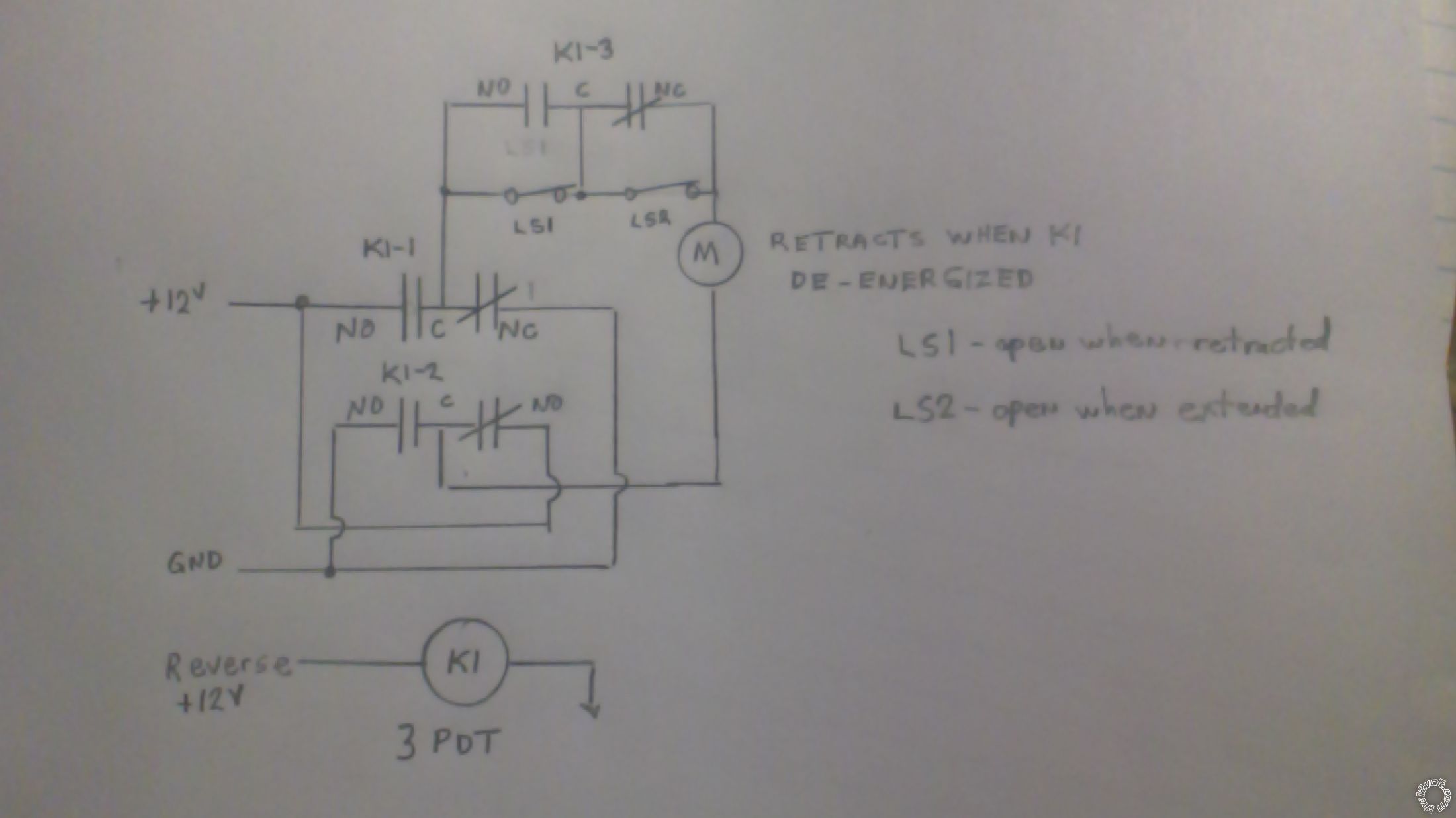

Posted: March 07, 2020 at 6:36 AM / IP Logged Link to Post Post Reply Quote eguru
1952 Chevrolet Pickup, Rear View Camera - Last Post -- posted image.
LS1, LS2 - are NC switches which become open reaching the retracted and extended positions (respectively);
M - is your gear motor - connected so that it rotates towards retracted when K1 coil is not energized by reverse 12V;
K1 - is a 3PDT relay (or 2 DPDT relays if easier to source);
Check out my logic on this.
When retracted, LS1 and K1-3 NO contacts are open so motor is not powered.
When reverse energizes coil of K1, K1-3 NO contacts close and bypass LS1. Motor rotates towards extended position until LS2 is activated (opened). Motor stops.
When reverse 12V drops off, K1-3 NC contacts close to bypass the open LS2 switch. Motor rotates towards retracted position until LS1 is activated (opened). Motor stops.
