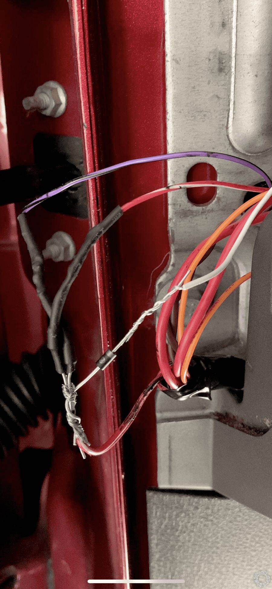

Photo taken just before soldering in the third diode, with everything tested and working at this point. Viper SmartStart VSM450 and DEI 535t Window Modules - FYI - Last Post -- posted image.

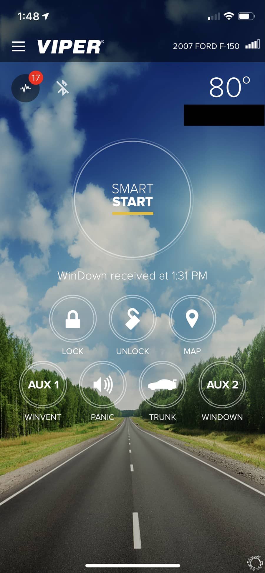

Screenshot in SmartStart (classic dashboard view):
