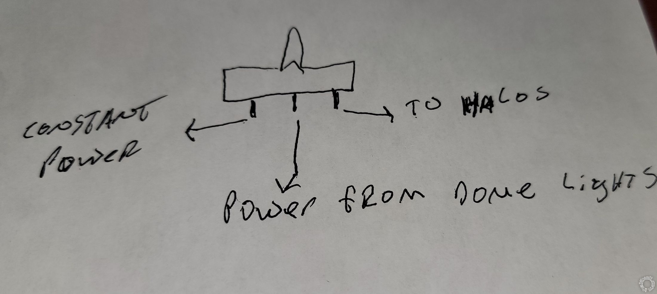

Posted: May 10, 2021 at 8:43 PM / IP Logged Link to Post Post Reply Quote ww421jr
V.3 Fusion Color Change Halo - Last Post -- posted image. 2007 Dodge Charger R/T

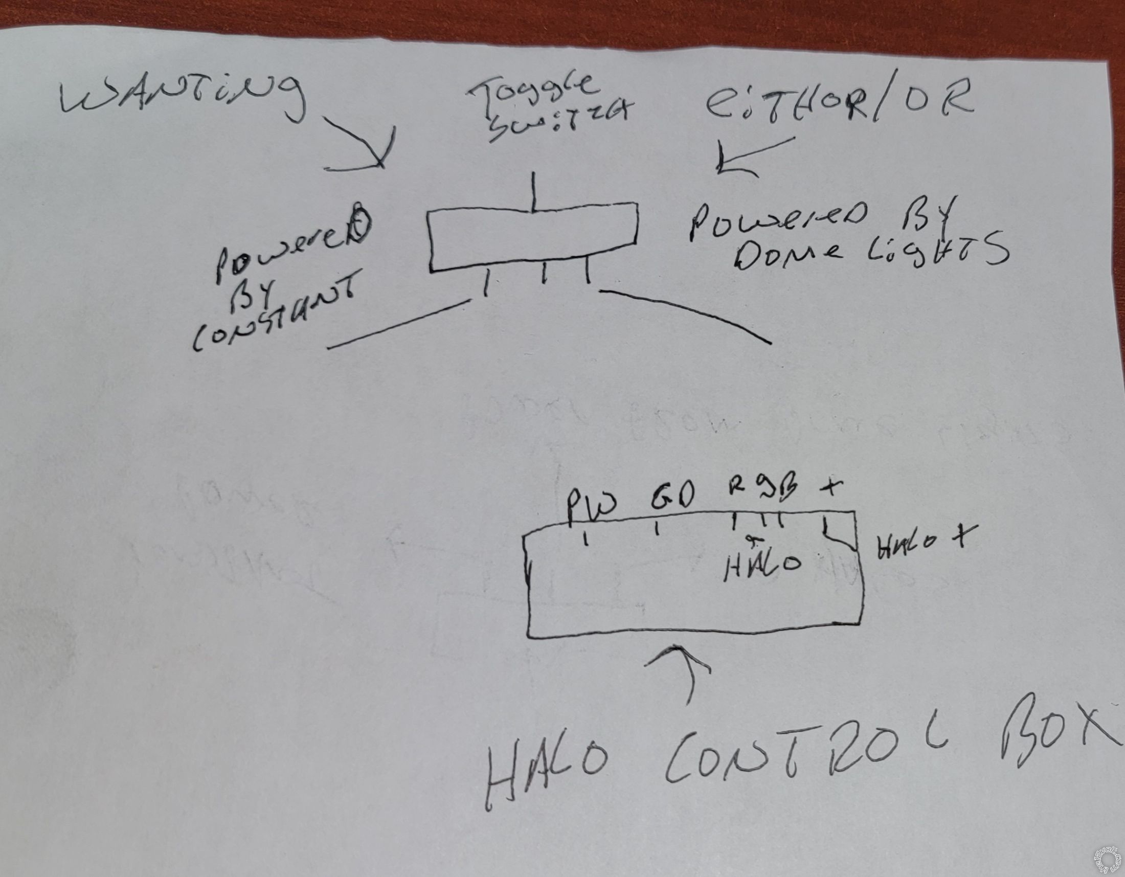

Posted: May 10, 2021 at 8:54 PM / IP Logged Link to Post Post Reply Quote ww421jr
This is what I want to be able to do, does it make sense and can it be achieved using relays. sorry for the poor drawing.

Platinum - Posts: 13,726
Posted: May 10, 2021 at 9:51 PM / IP Logged Link to Post Post Reply Quote i am an idiot
Middle pole to Halos.
Constant to terminal on one end.
Power from dome to the other terminal.
No diode needed.
If you use an On-Off-On type of switch you will be able to have the halos to come on with the domelight, or with the switch, and also turn them off.
Posted: May 10, 2021 at 10:00 PM / IP Logged Link to Post Post Reply Quote i am an idiot
Your bottom picture is missing one line to make it work. From middle terminal of switch to the PW terminal of the halo controller.
You drew the 2 components in the perfect place. Just draw a line from middle terminal of the switch straight down to pw on control box.
