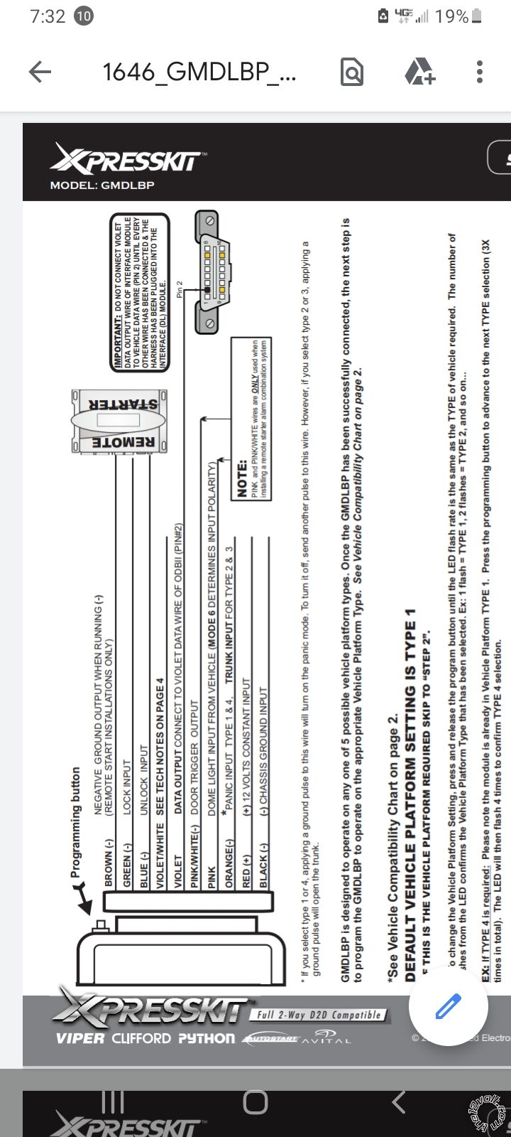

As for the bypass modules Brown wire, it needs to see a signal called (-) Status Output or (-) GWR ( Ground When Running ). Some R/S controllers used to call it (-) 3rd Ignition. Not sure what capabilities your EBay system has, hence the request for more info.

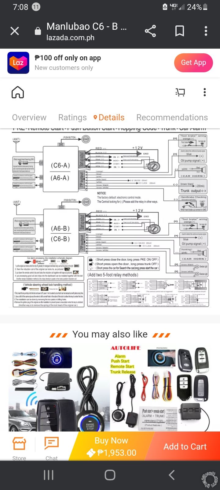

Gotta love these "off-shore" items.  Good news and bad news... A quick review of the diagram.
First the good news : The system can support both vehicle Ignition wires. If you don't power the White IGN2 wire during a R/S, you will cause problems.
With a couple of relays, you could add support for the Brown ACC2 wire. May not be necessary but...
Plenty of bad news : It appears that the system monitors the Oil Pressure to determine if the engine is started. This is a poor substitute for using a quality Tach Signal and fraught with problems. Typically inexpensive, low quality systems employ the oil pressure method.
I can't find a signal called GWR or one that could be used as GWR. The instructions seem to talk about placing the transponder chip in close proximity to the steering column pick-up antenna. However, your vehicle uses Passlock2 and does not have a transponder chip in the key. While you could do a hard permanent Passlock2 bypass instead of using the GMDLBP module, it would further compromise vehicle security. As part of the install you actually place a cut key into the ignition switch and leave it at ACC. It is possible to create a (-) Ignition signal using two relays that might work as the GMDLBP Brown GWR input. ( GWR usually precedes IGN1 by one second ). There is only one +12V power supply wire for the system. Not sure if this input wire is even fused. However, the typical R/S system used on these trucks has two +12V input wires each fused at 30 Amps. I am not sure what the normal current draw is to R/S and run this vehicle but I do know all the ignition wires are 12 gauge with the exception of the White IGN2 wire ( 14 gauge ). The vehicles' +12V constant wires going to the ignition switch are rated at 30 Amp ( Red ) and 40 Amp ( Red/White ). Of course with some more external relays to power IGN2 and ACC1 & ACC2, you could safely power the ignition wires with out overheating the PKE / R/S system or the lone +12V input wire.
