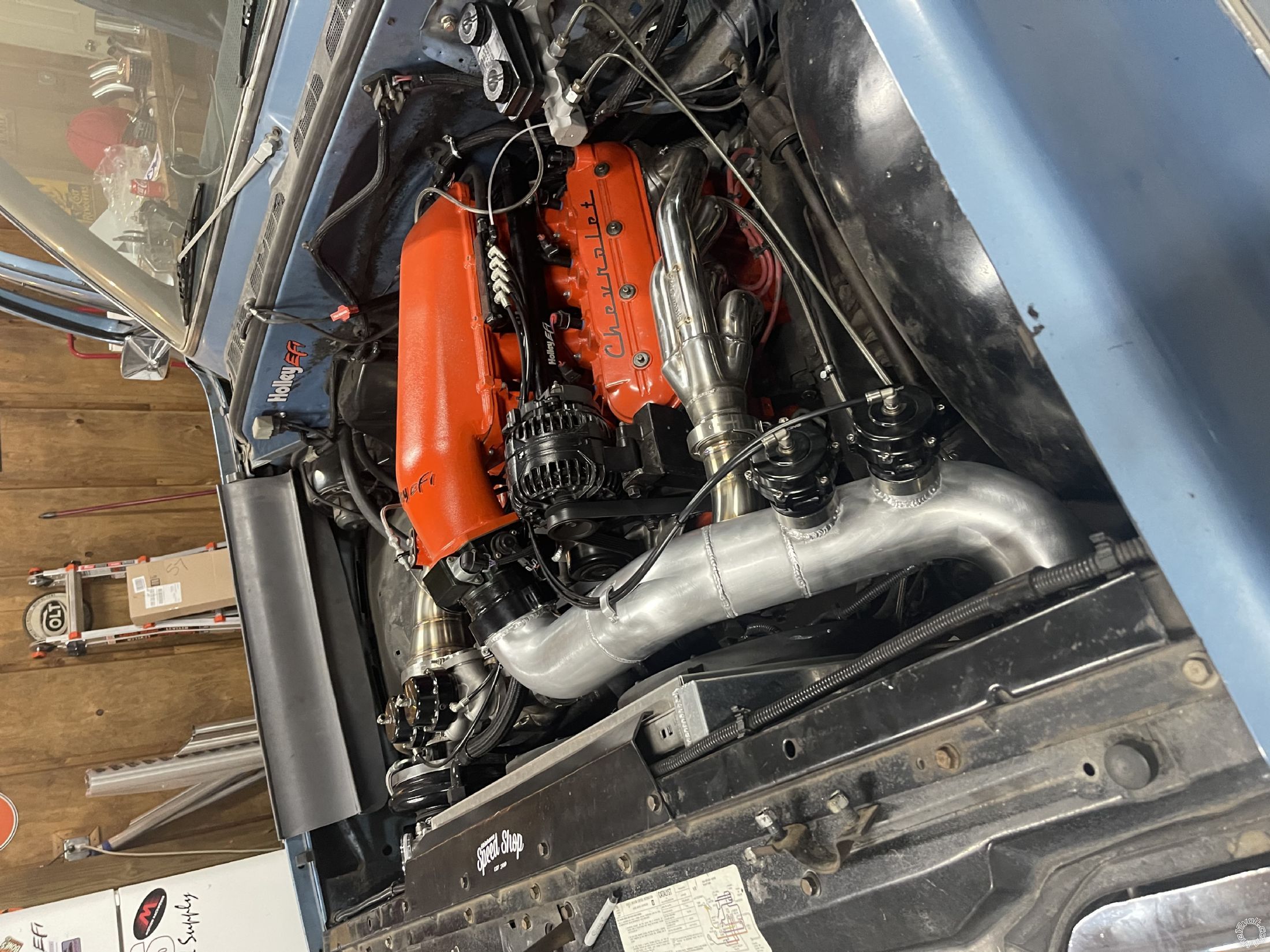

Cool! Glad to help, nice looking underhood. Might be fun to drive.
