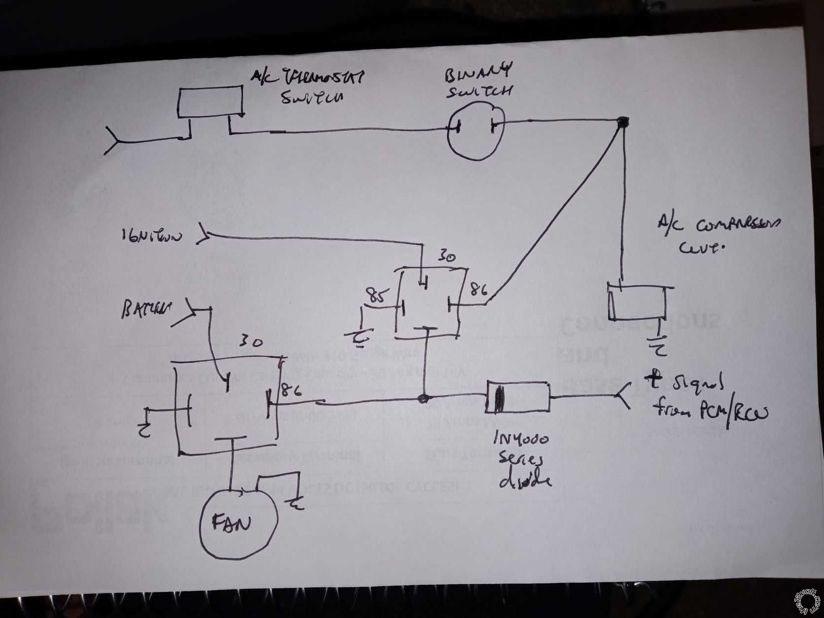

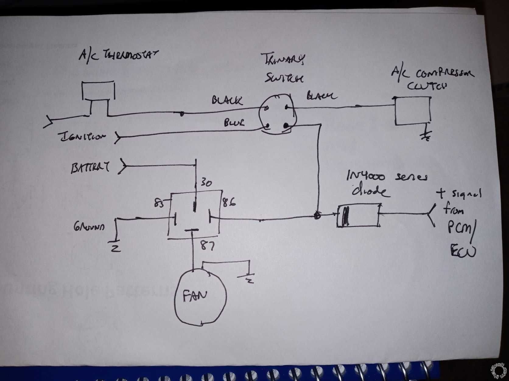

Folks, 1st post. I understand how a single relay works, but not the logic when employing 2 or more. I have a vehicle that uses a single electric radiator fan. It employs a single 40 amp relay which is triggered by +12 VDC signal from the engine ECU (Cummins R2.8 turbo diesel crate motor). By itself that works fine...but now the rub. I also need to find a method to trigger the radiator fan to come on when I turn on the A/C. The only diagrams I have been able to locate are based on signals to ground, not +positive , as that seems to be how all the thermostatic, binary and trinary pressure switches operate. When they reach their respective values, they all go to ground as the trigger for engaging A/C compressor and the radiator fan via a relay. So how do I incorporate a 2nd relay that will allow the ECU to call for cooling (turn the fan ON & OFF) when the engine needs it, yet still be able to turn the fan on when the A/C system is running? There will be times that the engine will not require cooling but the A/C system will. One of my concerns is feedback to the ECU, when both the ECU and the A/C system are requesting the radiator fan to turn simultaneously. I figure the 2nd relay would go where the manual override switch is in the diagram? A/C Cooling Fan Circuit For Dummies Like Me - Last Post -- posted image.

The trinary switch doesn't care if it switches positive or negative. So use a positive controlled relay circuit.
I would add a blocking diode (1N4000 series) in series with the PCM output, banded end towards fan relay.
This will isolate the PCM output from the trinary switch...keep 12Volts from backfeeding into PCM.
If you used a binary switch, wire an additional relay(coil)in parallel with the A/C compressor clutch. Also use
blocking diode on PCM. Have relay contacts supply power to fan relay coil.

Posted: May 28, 2022 at 10:58 AM / IP Logged Link to Post Post Reply Quote Ween
A/C Cooling Fan Circuit For Dummies Like Me - Last Post -- posted image.A/C Cooling Fan Circuit For Dummies Like Me - Last Post -- posted image.
Some quick sketches of the trinary or binary switch wiring.

Posted: June 06, 2022 at 9:37 AM / IP Logged Link to Post Post Reply Quote uh-1
Thanks again Ween, sorry for the delay, I was off-grid for 10 days. Your diagrams help me understand what is going on. I'll post when I finalize the install (or have more questions as to where I went wrong?)
