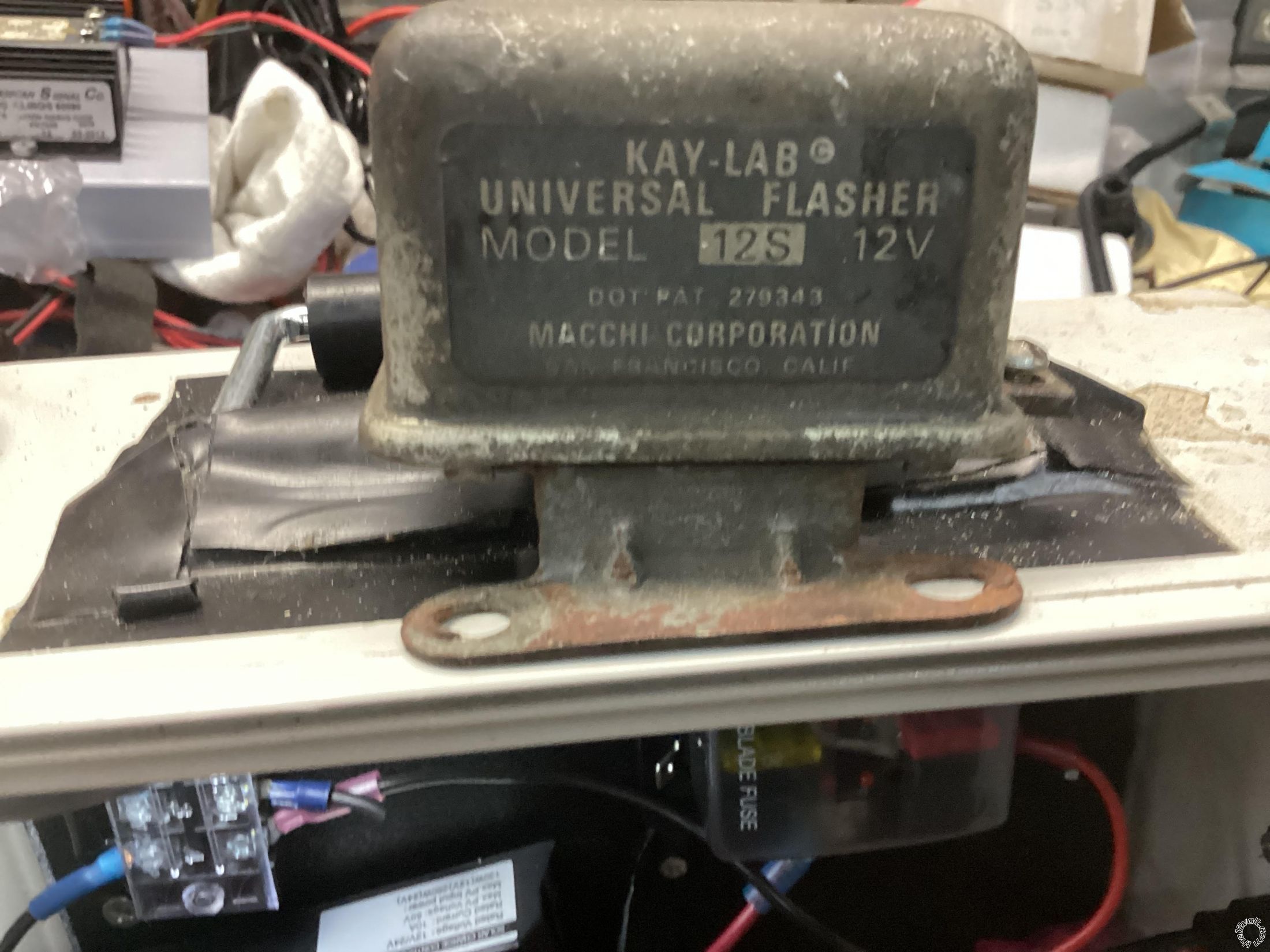

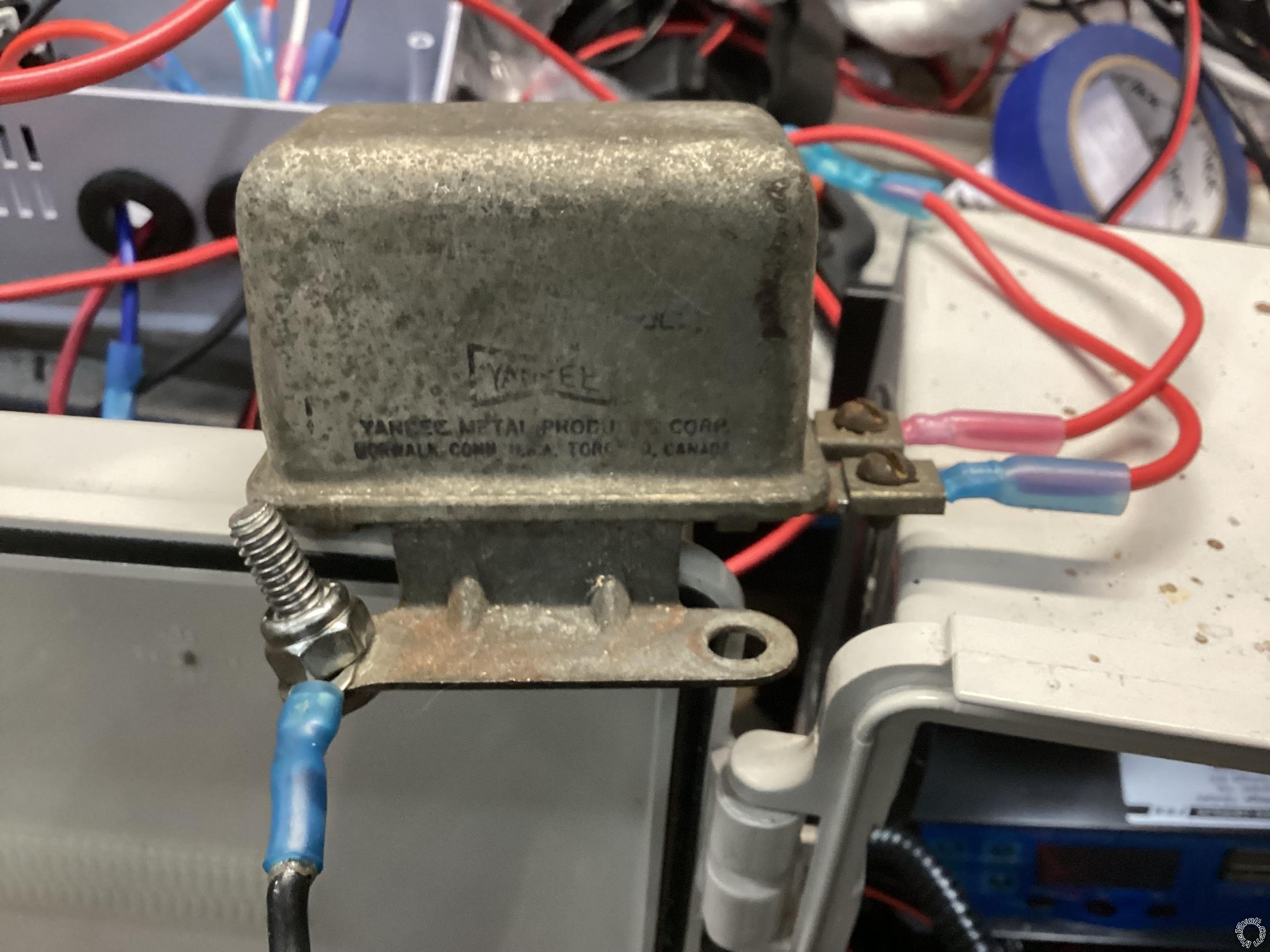

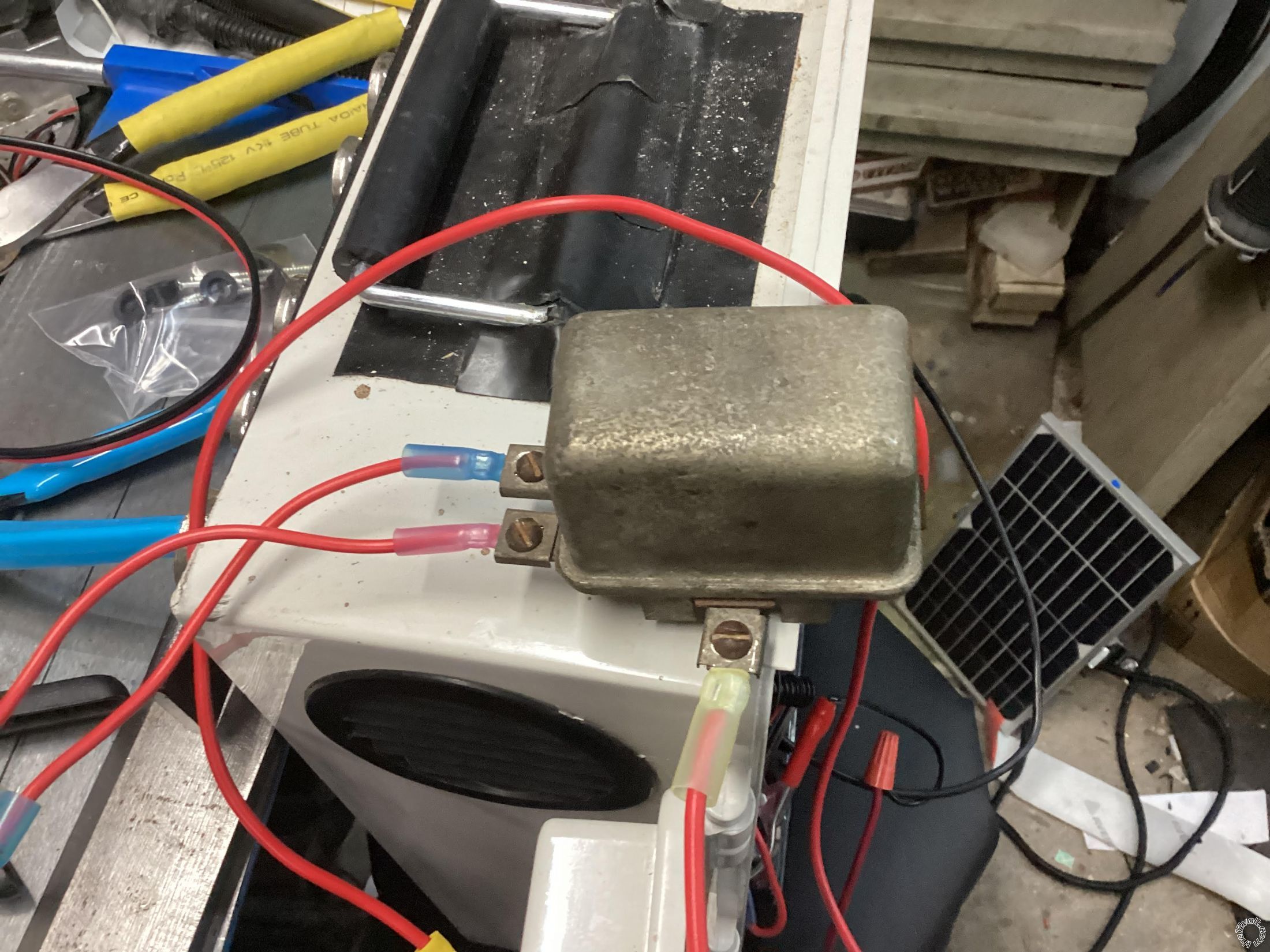

"I am an idiot", THANK YOU for all of your help. My apologies for not replying sooner but I was out of commission for almost two weeks and I'm just getting back into the swing of things. After trying two modern solid state flashers rated at 20 amps and having no luck, I dug out an ancient flasher my Dad had stashed from his Reserve Sheriff's Deputy days (1940's) and finally got everything to work !!!!. I can't thank you enough for taking your time to reply and offer your guidance.
I do have one last question. The alternating flasher switches back & forth a little faster than I['d like. It's not the end of the world but do you know any way to adjust this ? I included 3 pics of the flasher I used. Trying To Build A DIY Two Tone European Horn Siren - Last Post -- posted image. Trying To Build A DIY Two Tone European Horn Siren - Last Post -- posted image. Trying To Build A DIY Two Tone European Horn Siren - Last Post -- posted image.
Platinum - Posts: 13,726
Posted: December 30, 2022 at 6:50 PM / IP Logged Link to Post Post Reply Quote i am an idiot
There is no way to adjust the timing.
