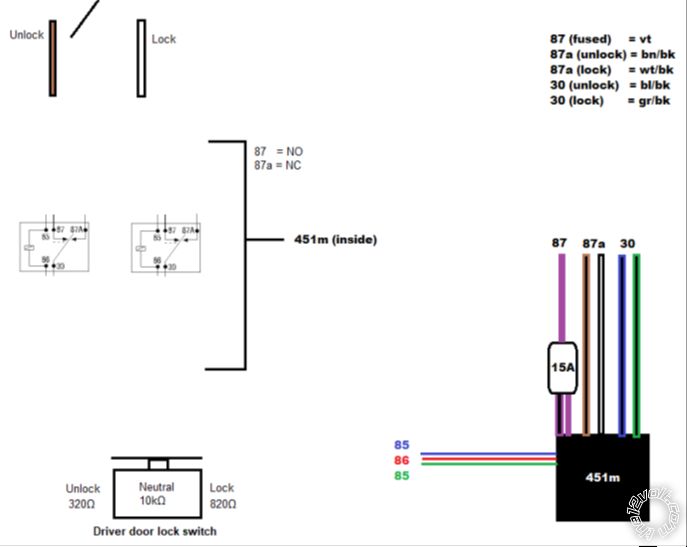

Is it possible to use the one-wire from the power lock switch with what I have available to send ground to either white or brown wires in a logical way? This can be in either a multiplexed fashion, a straight "ground pulse", or dealer's choice - I just can't wrap my head around how to wire this up properly 2003 Dodge Dakota, OEM Switch, Aftermarket Keyless Entry Kit - Last Post -- posted image. As far as I can tell, the brown and white wires are hooked up to a relay in this lock module so when you apply ground to one, it "closes that wire and switches to the other wire." Hopefully that makes sense...
(I also made this little drawing for trying to map out what I want to do...)

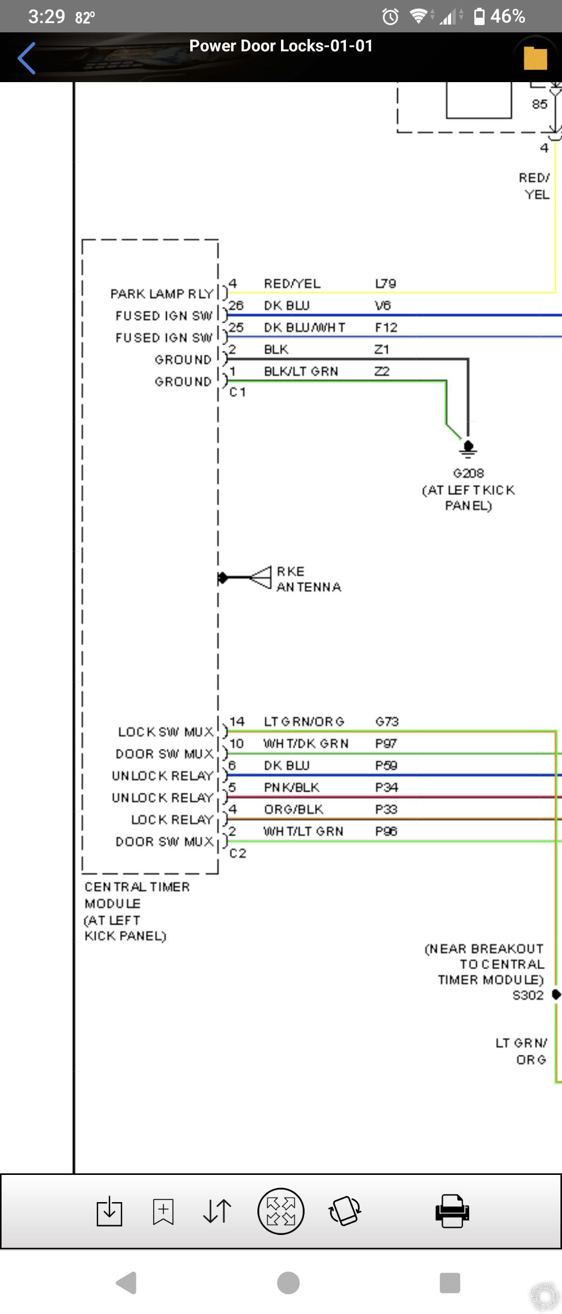

The actuator wires are connected to pins 4, 5 and 6: 2003 Dodge Dakota, OEM Switch, Aftermarket Keyless Entry Kit - Last Post -- posted image.

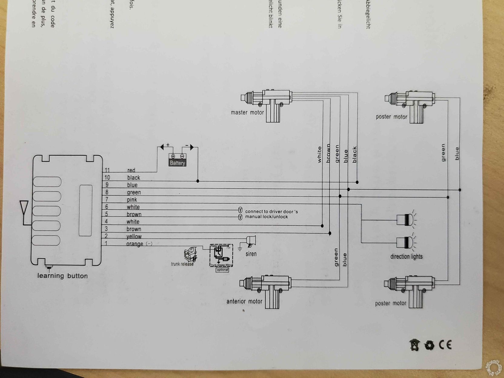

Since this is probably getting confusing, here's a wiring diagram that was provided with the cheap RKE kit:
