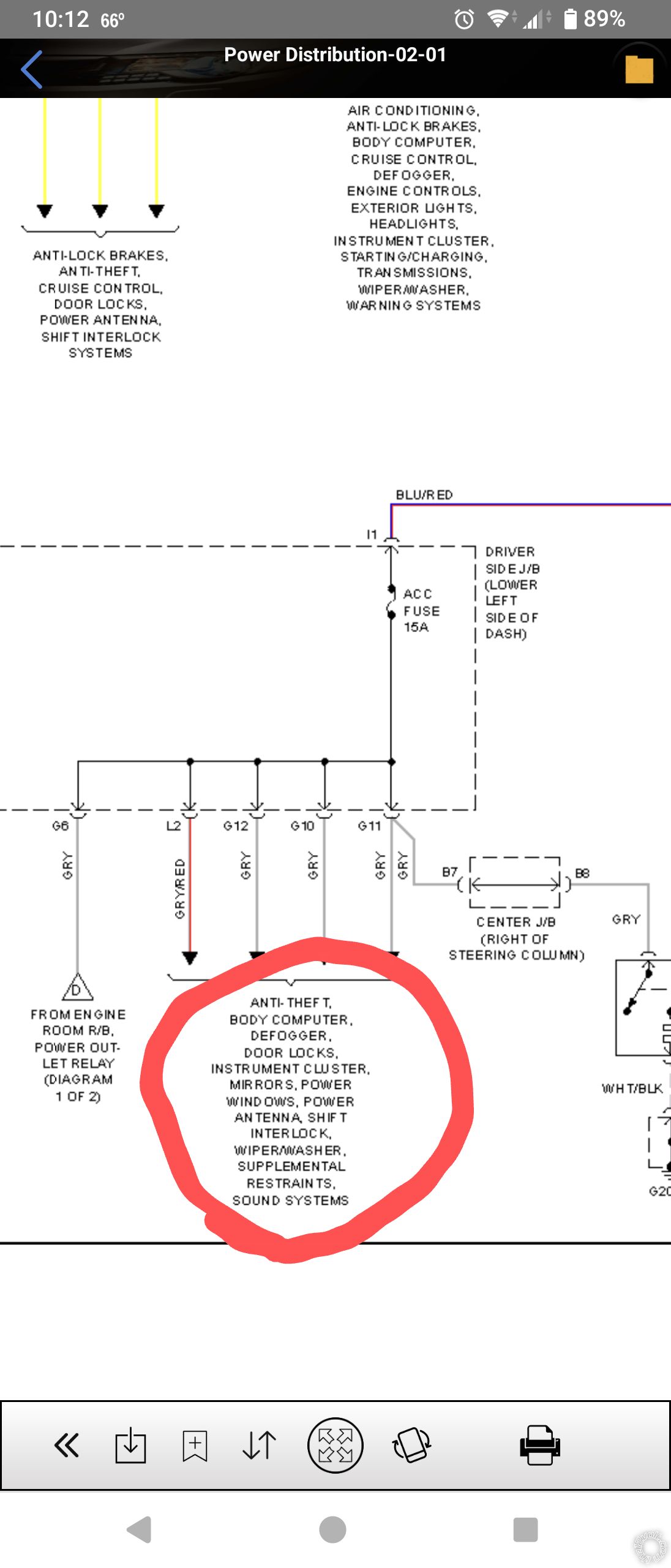

You didn't mention anything about the accessory wire. Here's a snapshot of the circuits it controls:
1999 Toyota 4Runner SR5, Compustar CM-900AS - Last Post -- posted image.
If it's not hooked up, I'd probably try that too.
